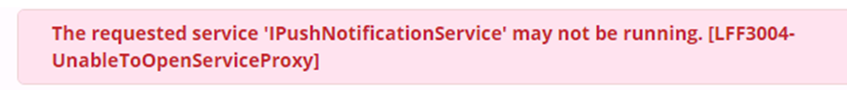

Forms: The requested service 'IPushNotificationService' may not be running.
asked on September 13, 2022
Hello,
We have a customer who is getting the following error when testing their "Notification Service" in the Forms Config
We have tried both "Localhost:8268" and "Customer's FQDN:8268" and same error.
There is nothing registered in either the Forms->Admin or Operational logs.
Anyone else seen this is error and if so, were you able to resolve it.
Appreciate the feedback,
Jeff Curtis

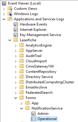

replied on September 16, 2022
Yep, I got that.
You will likely find your error with more details in the Laserfiche-Forms-NotificationService/Operational event log. Check there.
