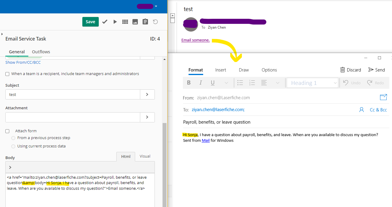

replied on September 6, 2022
Hi Hope,
The link does work for me from Outlook though &amp is saved. See screenshot below.
Could you elaborate how it doesn't work on your side?
replied on September 7, 2022
The body of the email was in the subject line but is working fine now
