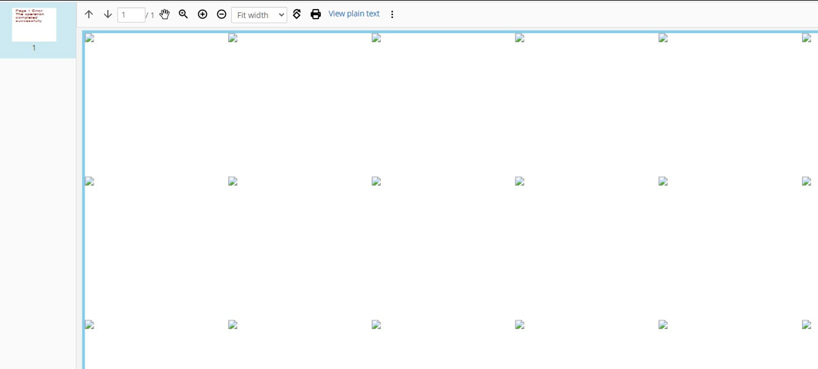

We upgraded to V11. Now we are having intermittent issues where the search in Weblink returns a list of documents but the images are not viewable. After restarting IIS and the APP pool images are presented correctly.

The way it's failing suggests something is going wrong with the export and caching process. There should be more information in the event viewer on the WebLink server machine.

I have a customer with this exact same behavior. After upgrading to version 11, tif images fail to load until the application pool is restarted. I have set the app pool to restart several times a day but still run into this issue.
