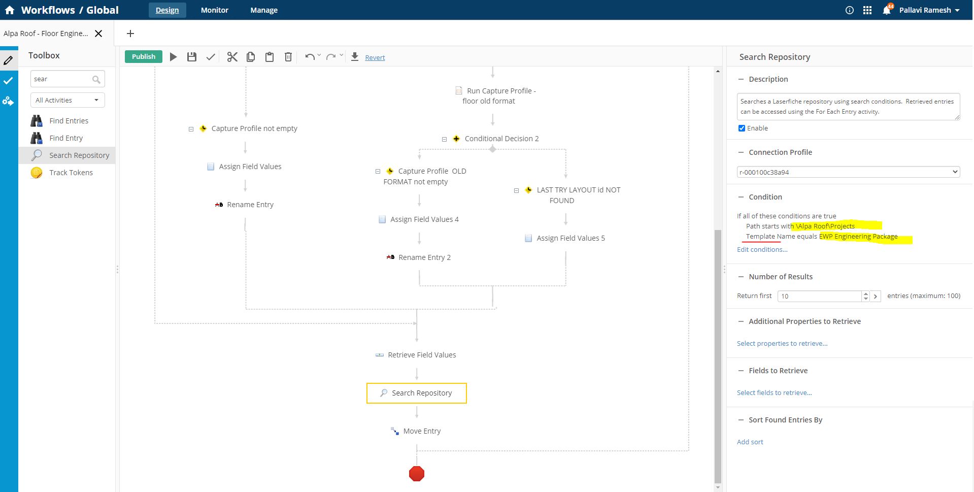

Hi Everyone,
I am fairly new to creating workflows and I am finding few difficulties when I am creating this new workflow. My goal for the workflow is to search the respository using the field value found by the workflow.
First, the workflow starts by finding the files in a folder( location provided in input),
Then it captures (using capture profile) the field value from the files and then use this field value to find similar files in the repository.
Here similar files are files which are named using this field value and they are already present in the repository.
The work flow I created is finding the original file in the location provided in the input, its not searcing in the entire repository for files having similar field value in their file name.

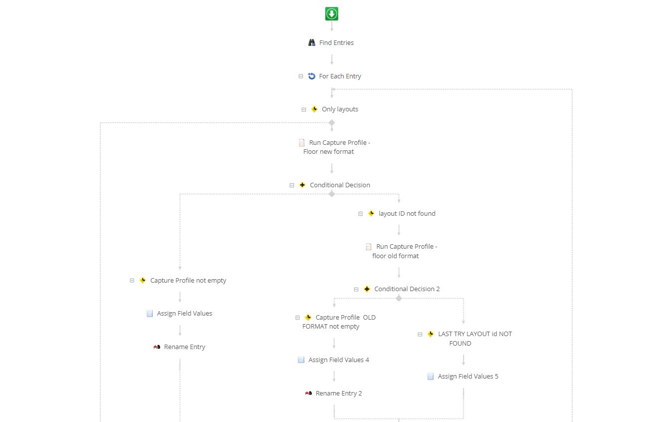

I have attached my workflow diagram, kindly let me know where I am going wrong.
Please and thank you.

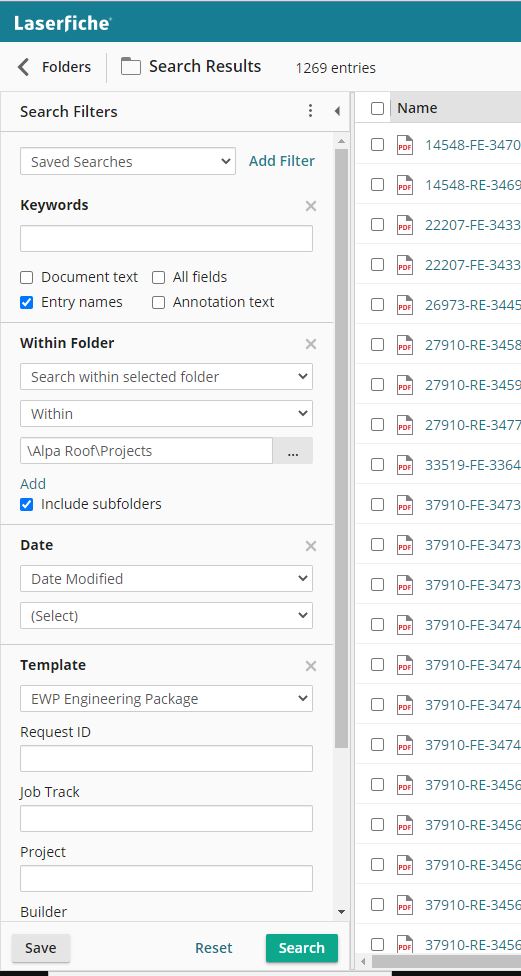

When I search manually in the repository with this number 322310-345886, it show me the exact 2 files which am looking for which is
  1. 47718-FER322310-345886
  2. 47718-FE-322310-345886
I want the workflow to do exactly this.

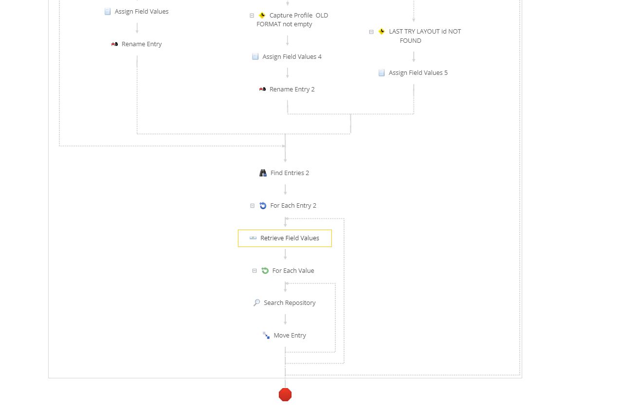

Because the Search Activity in Workflow cannot search by Filename or use Contains, there is not going to be a straight forward way to use Search to find your files.
Option 1. When the files are saved to the repository, create a metadata field called Filename and assign the files Filename to that field. Then you should be able to perform the search against the field and by adding * (wildcard) before and after the token it should. For example purposes I used a Comments metadata field here as I didn;t have a Fielname metadata field

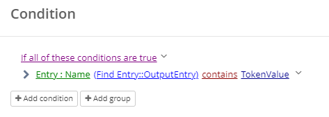

Option 2. You could try something like, where if you know the Folder that contains the files, either by Search or by knowing the path, you would then need to Find Entries in that Folder and check each one looking for the filename to contain the Capture Profile Token value as conditions can use contains
replied on August 30, 2022
Thank you Steve, the second option works because I know where the folder is in repository that contains the files am looking for. This solves it.

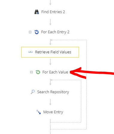

When multilple files are provided in Input, the retrieve field value would have multiple values and hence I have used the for "for each value loop". Since am still creating the workflow, I have removed the "for loop" and tried and still I receive the same output,, its not finding the files in the repository, its still taking the file which I provided in input.
And for the capture profile, I tried first with the capture profile group but capture profile was not giving me accurate values, hence I tried with this step.
May I know how I should create a workflow, where the workflow will first find a field value and then using this field value it has to search a file in repository whose filename has this field value.

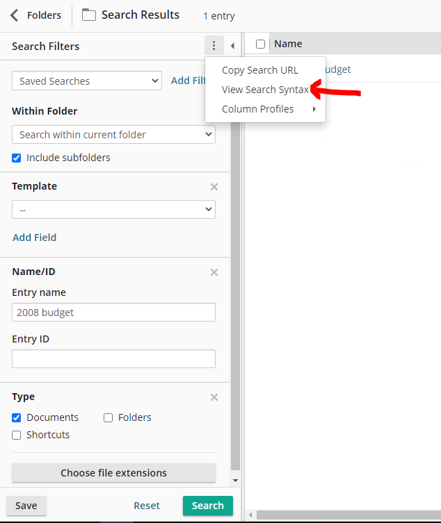

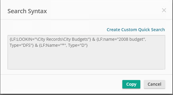

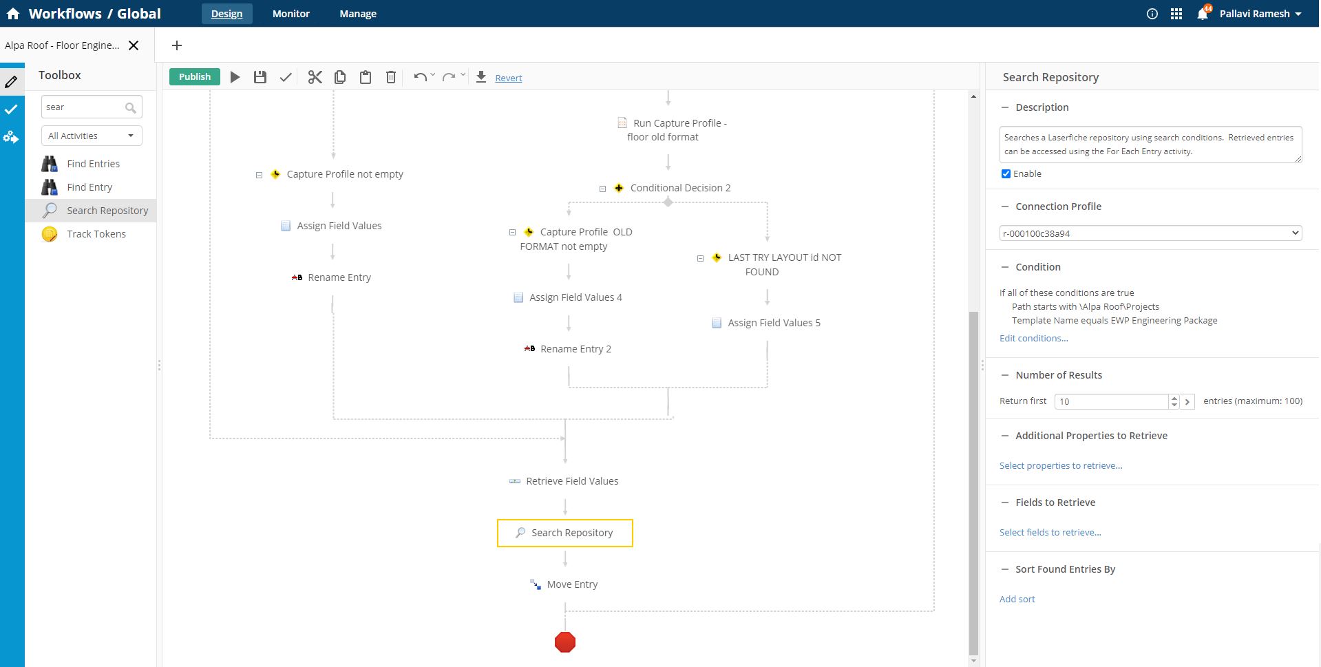

The way I do this, is I go to the Repository and create my search there until I get the results I want, and then I copy the Search Syntax and paste it into the Search in Workflow, using the Variable where my values were.
replied on August 29, 2022
  1. I have copied the search Syntax but I am not sure where I would add in my workflow
  2. Can you please confirm if the activities in workflow are accurate. After retrieve field values, I have used search repository activity.
Kindly advise, thank you.

Sorry, I overlooked that you were using LF Cloud. The search conditions in Cloud do not allow you to Search by FileName. Is it possible to find the documents based on any Metadata associated to the files?
Yes , we have templates assigned to our files, I have added that in the condition, however the workflow still finds the file I have provided in Input. I want to know if the workflow is using the value provided by the capture profile to search the repository? If I search manually in the repository with this value, I find the exact file am looking for.

In regards to your search, when you Retrieve Field Values, is the field a Multi-Value Tpken, if not, you would not need the For Each Value, but would just use the Retrieve Field Value Field in your Search
