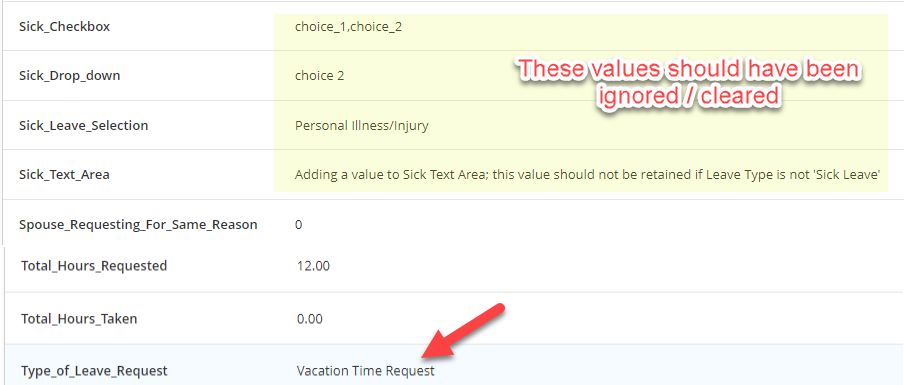

replied on August 25, 2022 Show version history
Thanks for clarifying Jason!  You are correct regarding the need for previous submission; I'm updating my posting accordingly.  I also took a screenshot of a modified Leave Request Form wherein I changed my Leave Type.  I have some fields I added that were only visible (and otherwise ignored) for Sick Leave, so when I changed the Leave Type on a subsequent submission those Sick Leave values should have been ignored.
