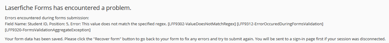

I am getting the issue [LFF2107-Submission Error] upon submitting a field.
This occurs due to using a regular expression on a Single Line field.
At first I tried "(\A|\a)\d{8}" then I tried "\A\d\d\d\d\d\d\d\d". Both cause the issue above.

Edit: Forgot to mention that the test string that I am using is "A00000000"

I believe your Regex is incorrect.
To validate A00000000 or a00000000 (First character is a or A, followed by 8 digits) your regex should look like
[aA]\d{8}  or [aA]\d\d\d\d\d\d\d\d
replied on August 25, 2022
Thank you Steve your expressions fixed it.
I was using regextester.com to check if my test strings would match my expressions. They would show as matching but maybe the regex on that website works differently than how LF does it.
