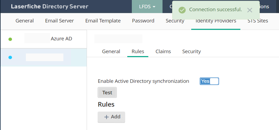

There is a test button on the Rules tab
replied on August 24, 2022
The Test button on the Rules tab is what I use. Not sure offhand if you have to have at least one sync Rule configured for it to actually check the IdP connection.
Yeah, we are not using AD Sync for any of our 10 identity providers.
Looks like the Test button requires "Enable Active Directory synchronization" = "Yes" but you don't actually need any Rules configured. You can toggle it on, select "Test", and toggle it right back off.
replied on August 25, 2022
That is good to know, thank you for checking on that. Could the Test button be copied over to the General tab so turning on Sync isn't necessary? I wouldn't have thought to go to the Rules tab to test the connection to my IDP.
The "Test" button is specifically checking running the group sync rules. This coincidentally involves connecting to the IDP as Step 1. It just doesn't commit the results of the group sync test. Makes it not quite as simple as "copying the button over".
