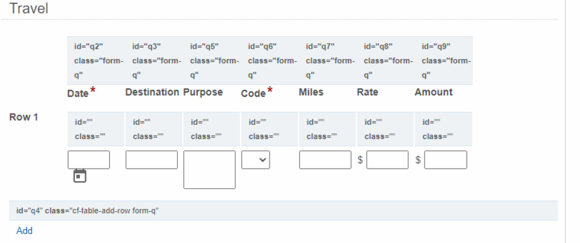

Here's the code I've cobbled together, though I know it's not correct.  Forgive me, my Javascript ability is far below what it should be.
    $("#q2").on("change", function(){
     var d2 = new Date("#q2").val();
     var d1 = new Date("07/01/2022");
      if (d2 < d1) {
    $("#q8 input").val("0.55");
    else {
      $("#q8 input").val("0.65");
Here's my table:
