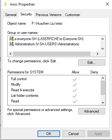

Is it an option to configure permission on the folder or profiles in the network drive? I think Laserfiche Connector is a client application, so if the user running Laserfiche Connector doesn't have access to the profiles in the network drive, the profile will not be loaded.

Yes, Connector does run with the user's permissions, so I believe it is possible to limit profiles by limiting the user's access.
However, because Connector doesn't check subfolders, folder security is effectively the same as just not mapping to the folder.
Setting security on the individual files should work, however, it is not very manageable since all the files would still have to be in a single folder and it would require setting/maintaining permissions on the individual files.
There's just a lot more that can be missed/overlooked when using file-specific security as opposed to named subfolders, so we went a different way.
