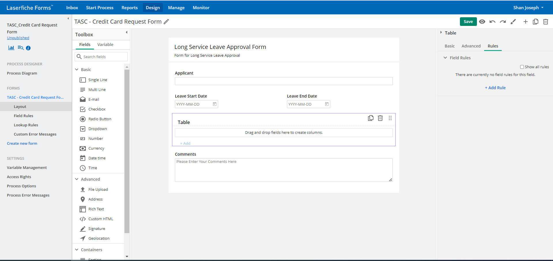

I am on V11 and am trying to find Lookup Rules after inserting a table. On the older designer there is that option however on V11 this seems to be missing. Where can I find the Lookup Rules for tables?

Sorry I must be missing it, but I can't see any such tab on the right, for other fields it has a lookup rules option however for tables it just has a field rule. See below.

I notice you're using a table, what if you drag a single line field onto the canvas, do you see the lookup option then?
I'm fairly certain you only get the lookup options in a column within a table, not on the table itself, that might also explain why it's missing in your screenshot.

Thanks, yes that is the way I have been doing it, I wanted to make sure that was the correct way as in the classic version you could just add directly to the table.
It works so I guess this is the way.
