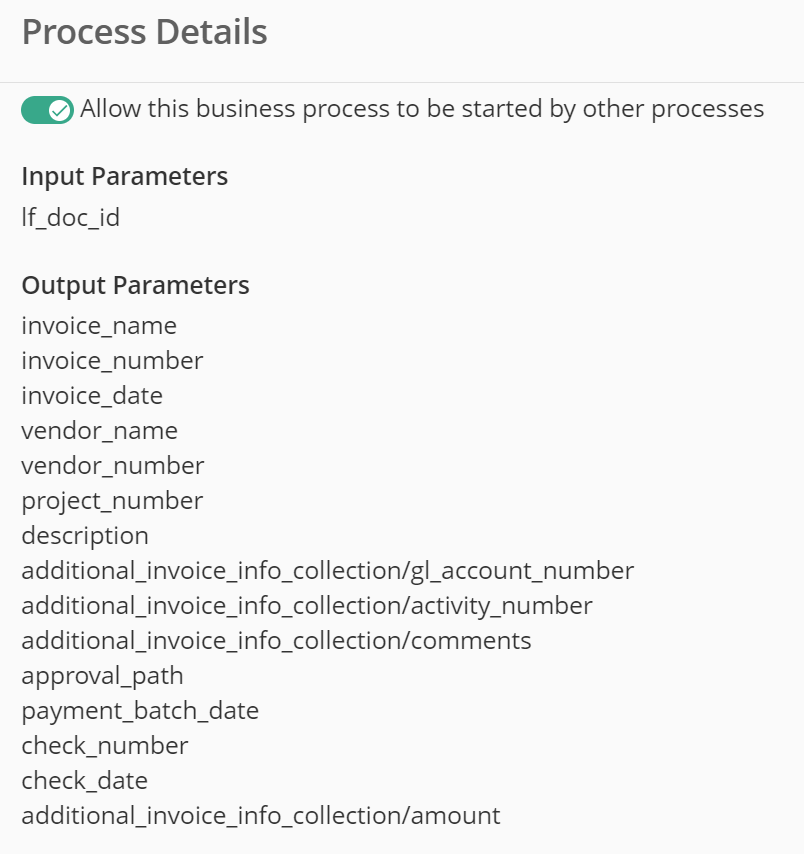

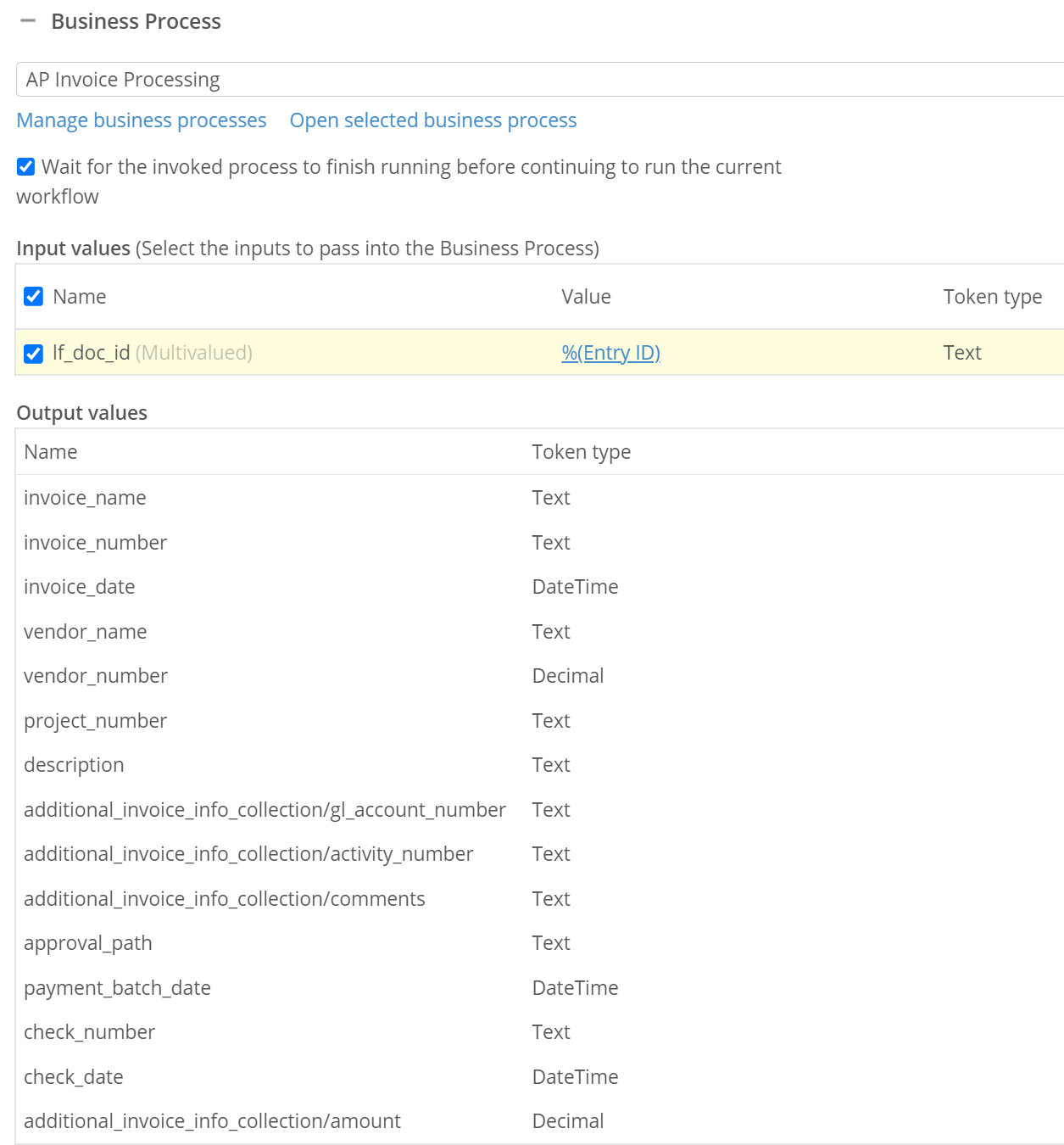

I'm am currently developing a process for a customer which entails a workflow invoking a business process (passing one parameter in, which I have tested is working), waiting for the business process to complete (the "Wait for the invoked process to finish running before continuing to run the current workflow" box is checked), and a number of parameters being output from the business process on completion to the workflow.
I have setup the output parameters within the business process, and am able to see their tokens within the workflow (under the Invoke Business Process activity). However, whenever I try to use these tokens either by selecting them in the drop-down or using the token dialog, clicking on any of the tokens does not add them to the field.

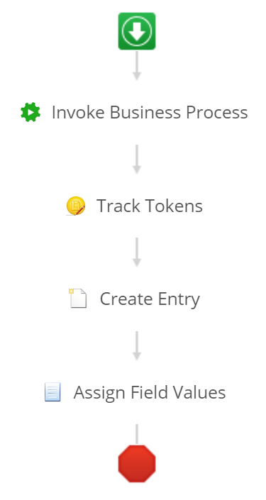

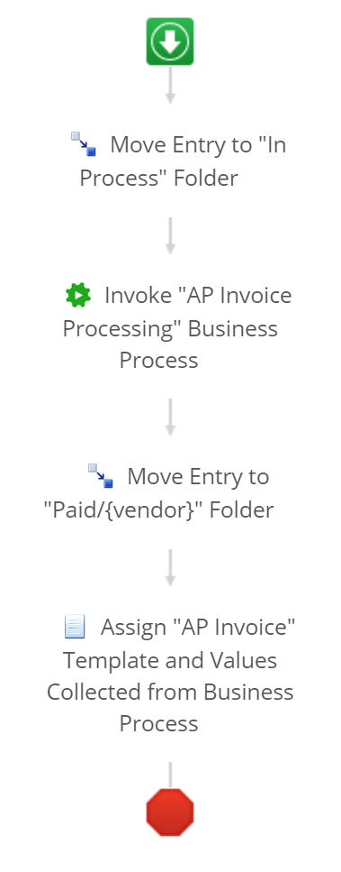

The workflow
Details from the business process settings
The invoke business activity details

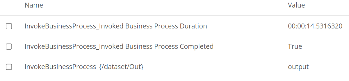

The tokens I'm seeing (none of which get added to the field when clicked (the "Destination" field in the "Move Entry" activity directly after the invoke)
replied on August 11, 2022
Oh, completely missed that this is cloud. Sorry about that. You are correct, cloud Workflow can wait for business processes.
It's a bug caused by the double quotes in the Invoke activity's name. Reference ID 390939. Thanks for reporting it. Renaming the activity without double quotes will make the picker work again.

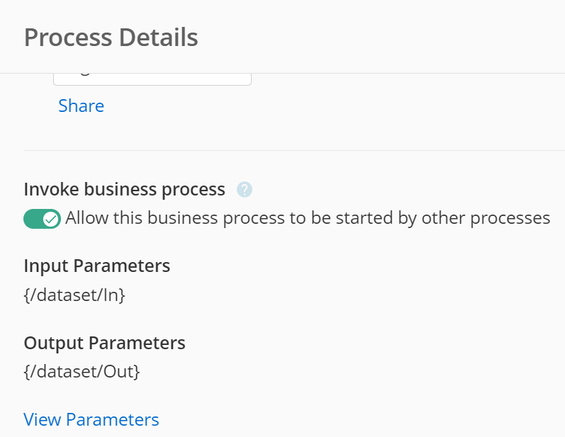

It's clearly possible to pass values from invoked business process to workflow. When the "Wait for the invoked process to finish running before continuing to run the current workflow" box is checked, the output parameters specified within the business process show up as tokens under the invoke activity.

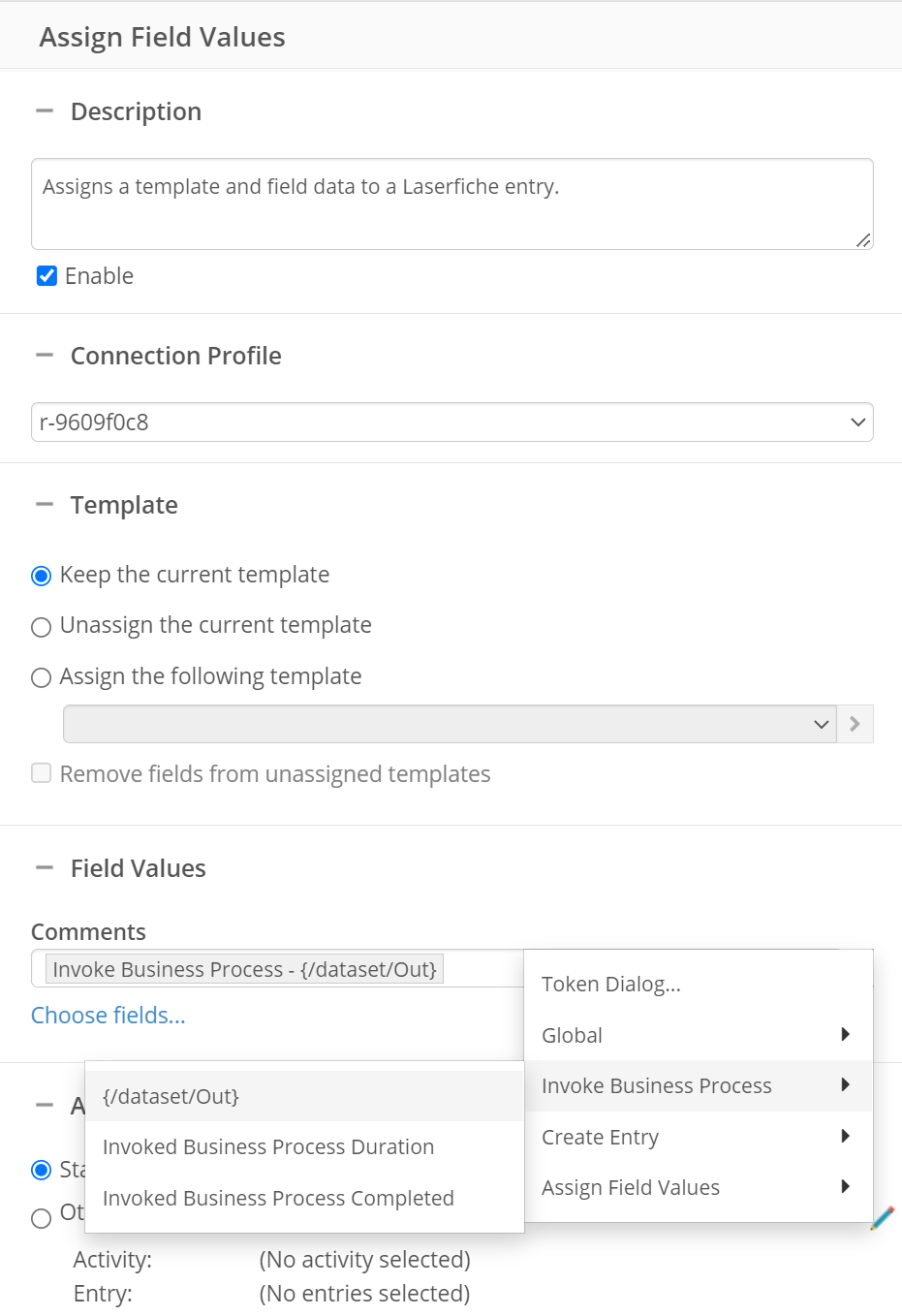

I created a compact testing workflow/business process combo just to test the passing of values from invoked BP back to workflow and it worked just fine.
I'm still not sure why my original workflow isn't letting me set the values in fields, but my current plan is to try and recreate the invoke and assign values activities, and if that doesn't resolve it I'll reach out to to LF support.

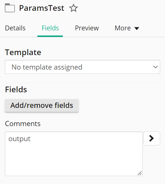

Business Process Details
Workflow Details
replied on August 12, 2022
Ah, got it. I'll remove the quote marks for now then.
