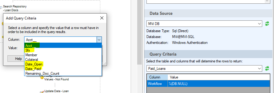

I'm sorry, but I'm not sure what exactly you're asking to see. My query data step is below. The highlighted columns are the data point tokens that are being used in the search step.

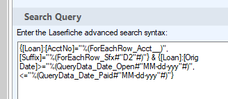

Then in a For Each Row loop, I have this search repository step.

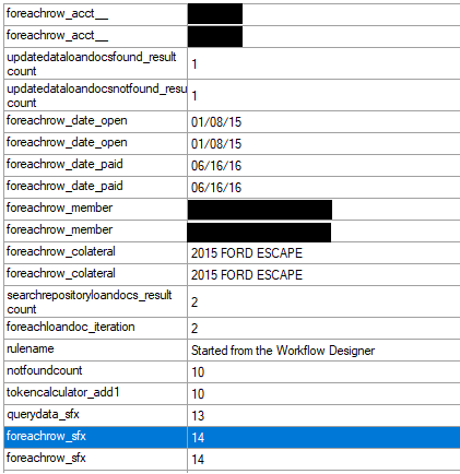

Here's a sample of the tokens from a previous run. I had to black out the acct number and name for security though. I'm not sure how to link the tokens though.

The search query is the part I was looking for, it's where you use the values retrieved from the DB. Does it work manually with these exact values?
If not, I'd try using the For Each variable for the Date Open and Date Paid. You might also want to add the template to Suffix (i.e. [Loan]:[Suffix] vs. [Suffix]). Other than that, try removing elements from the Search Syntax until you find one that works.  Then you can add and test elements one by one.

It does work if I put in a specific account number for the query step, even if it was one that had failed previously. It's a very strange issue because it works if I run it one row at a time, but if I run it for a batch of rows, it doesn't work for every row.
replied on August 15, 2022 Show version history
In that case, make sure all of the variables in the query are of the "ForEachRow_" type.
Thank you so much! The Query Data tokens appear to be what was messing up my search and I hadn't even noticed that I used Query Data instead of For Each Row tokens! It is working now! Thanks again!
