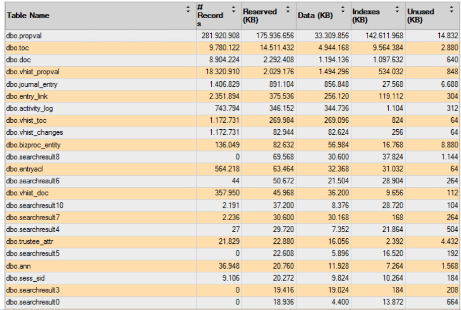

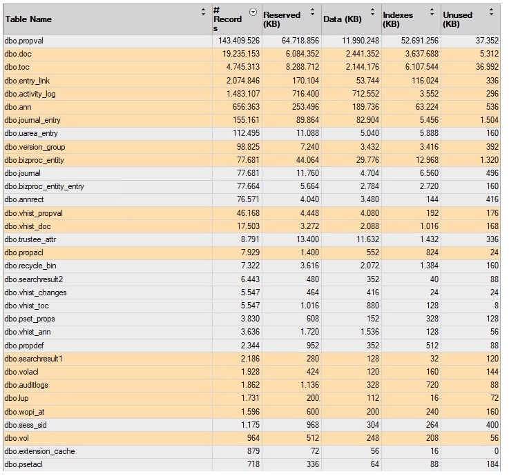

Here are 2 examples of the table sizes in the repository database of 2 of our customers where this situation has been occurring:
Customer 1:
Customer 2:

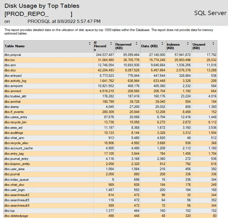

The first thing that jumped out at me is that those SQL reports show extremely high Indexes to Data size ratios for the propval (metadata) table. We spot checked a few well-performing large repositories and found the Indexes were usually 1.5-2x the Data size.
Your Customer 1 and Customer 2 have propval Indexes almost 5x the size of the Data. Here's an example from a real customer repository with pretty close to the same propval record count of Customer 2:
We suspect this indicates your customer's repository databases are desperately in need of index and statistics maintenance. I wrote a reply about doing so in another Answers post here: Re-indexing in MS SQL for Laserfiche Database
