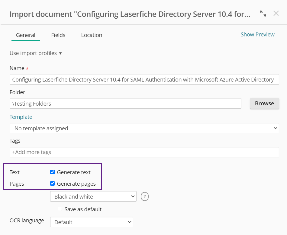

We have a customer that is importing PDFs that have no text layer and they are not getting OCRed.  Is there an option to designate using an alternative method so that the resulting images get OCRed?  They do not want to have to install and use the desktop client.

Do they have both "Generate Text" and "Generate Pages" selected on import?
I believe PDFs without a text layer require page generation for OCR.
replied on August 4, 2022
Yes they have both selected and the Pages are generated (PDF is not kept), but the text is never generated.
