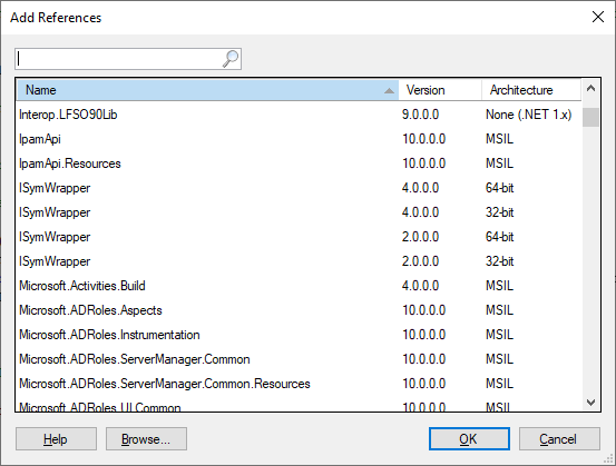

Here is my list of references:
When I went to add a reference, no Laserfiche items appear in this list.

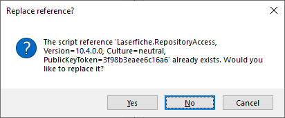

I enabled file browsing and went to the GAC and tried to add the repository access and get this:
I clicked yes and the error message still does not resolve.  How would I fix this?
