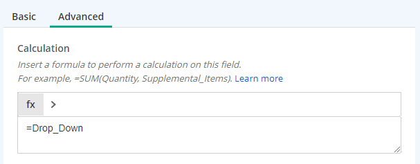

You don't need JavaScript, you can just use Calculations.
When you edit the field, click Advanced, and under Calculations you can just set it equal to the dropdown variable.
For example, if you're just taking the value from one field and copying it to another
