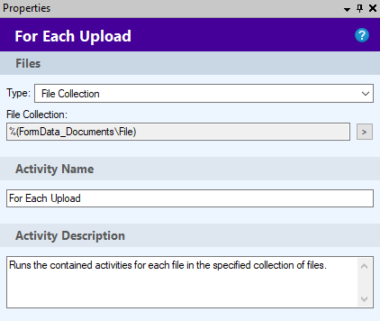

  1. Add a token to the workflow configured as a Boolean with the default value set
  2. Retrieve the file upload field using Retrieve Business Process variables
  3. Add a For Each File activity with that variable as the File Collection source

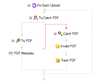

  4. In the loop, add a try-catch

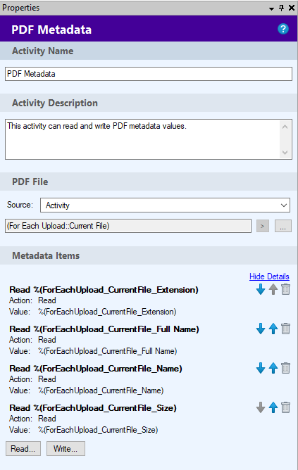

  5. In the try catch, add a PDF Metadata activity to read some of the file properties
  6. In the Catch block, flip the value of the boolean token
  7. Pass that value back to the Form to indicate that a "protected" file was detected
This is the closest I've come, but it catches pretty much all of the files that can't be opened without a password, as well as some corrupt files, and has been pretty effective for us.

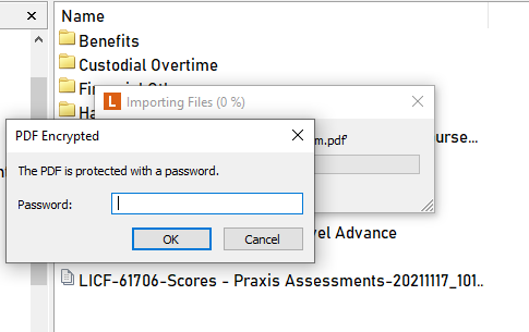

An error occurred during the execution of the Save to Repository service task. [LFF5426-ErrorExecuteSTR] Details: URL: Error: ErrorExecuteSTR Date: 7/20/2022 2:41:26 PM (Eastern Standard Time) HTTP Status Code: 500 Business Process ID: 126 Instance ID: 76172 Business Process Name: BeWell Incentive Forms Stack Trace: Caught exception: Laserfiche.Forms.CommonUtils.Exceptions.LFFormsException Message: An error occurred during the execution of the Save to Repository service task. [LFF5426-ErrorExecuteSTR] at Laserfiche.Forms.Routing.SaveToLaserficheService.Execute(Int32 instanceId, IRoutingContext routingContext, RoutingInstanceStatus OriginalStatus) at Laserfiche.Forms.Routing.ServiceTask.Execute(Int32 instanceId, IRoutingContext routingContext) Inner exception: System.Exception Message: Password needed at Laserfiche.PdfServices.PdfExtractor.LoadFile(Stream pdfStream) at Laserfiche.PdfServices.PdfExtractor.ImportPDFPagesFromStream(Stream pdfStream, DocumentInfo doc) at Laserfiche.PdfServices.PdfExtractor.ImportPDFStream(Stream pdfStream, DocumentInfo doc, DateTime dtLastModified) at Laserfiche.Forms.CommonUtils.LFHelper.TryImportAttachment(Session sess, cf_bp_attachment_data attachment, FolderInfo parentFolder, String volume, String attachmentName, String ext) at FormsModel.RoutingModels.Services.SaveFormToLaserficheStrategy.SaveAttachmentToLaserfiche(Session session, XmlDocument datasetXml, STLConfigurationObj conf, DocumentInfo rootddoc, String timeZone, String rootFolderPath) at FormsModel.RoutingModels.Services.SaveFormToLaserficheStrategy.SaveToLaserfiche(Session session, XmlDocument datasetXml, List`1 STLConfigList, SaveToLaserficheParameters saveToLaserficheParameters) at FormsModel.RoutingModels.Services.SaveToLaserficheHelper.OpenSessionAndSave(IEntityContext _AppContext, Int32 STLRepositoryId, List`1 STLConfigList, XmlDocument datasetXml, ISaveToLaserficheStrategy saveToLaserficheStrategy, String timeZone) at FormsModel.RoutingModels.Services.SaveToLaserficheHelper.SaveToLaserfiche(IEntityContext _AppContext, Int32 STLRepositoryId, List`1 STLConfigList, XmlDocument datasetXml, ISaveToLaserficheStrategy saveToLaserficheStrategy, String timeZone) at Laserfiche.Forms.Routing.SaveToLaserficheService.Execute(Int32 instanceId, IRoutingContext routingContext, RoutingInstanceStatus OriginalStatus)
replied on July 20, 2022
Required password when I drag into Repository too

A few things to note with the workflow approach:
  1. Make sure you add a hidden field on your starting form to hold the "valid/invalid" variable so it can be used in a gateway.
  2. Since Forms doesn't have a "boolean" type, the value will get passed back as text (i.e., "true" or "false")
  3. The gateway condition will need to match the value passed back to the form so make sure to test it a few times
Alternatively, instead of passing back a true/false, you could just have it be a normal string field that starts blank and only gets a value set when a bad PDF is detected.
That way you could have the gateway condition just check if it empty or not.
Either way, I would have one path check for a "valid" condition and have the "reject" path be the default since you should always have one default path without a condition and I prefer to have things "fail closed" in most cases.
