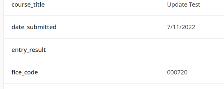

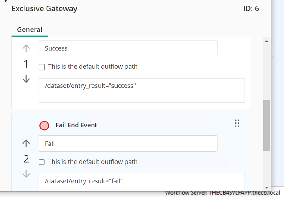

Hi Miruna - Yes, we set the service task to wait for the workflow to finish. Then we check the values (or check for the values) in an exclusive gateway:
In WF, the token "Entry Result" is set to a default of "fail", and switches to "success" if it does not hit a Catch branch. So something has to go back to the BP, yet the BP shows no value:

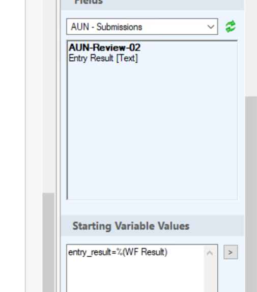

Here's how we try to update the variable:
