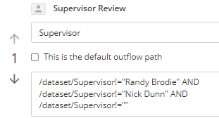

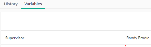

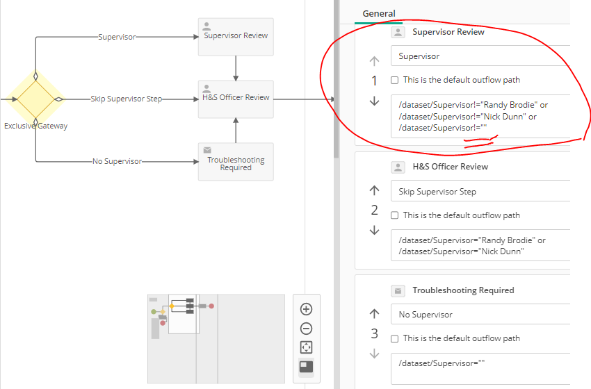

Could someone help me troubleshoot why I can't get a Forms process Gateway to take a path based on a field variable being NOT this or that (being NOT this supervisor or that supervisor)?  Of note is that it was working when there was only one supervisor they wanted to skip this step.  But now that I'm trying to make it skip for two different supervisors, I can't get it to work.  Here is my last configuration attempt and negative result:
  • It did assign him to the Supervisor step:
  • This was the name in the Supervisor field:
  • This is how the design process Exclusive Gateway was set up:
replied on July 13, 2022
You are saying: Not equal to A OR not equal to B OR not equal to {empty string}.
This will always avaluate as TRUE because any one of the three options being true will evaluate the whole thing as TRUE.  A is false for one, but true for the other two - same with B and empty string - C is true for all three.
I think you want to use AND instead of OR.
Not equal to A AND not equal to B AND not equal to {empty string}.
Now all three have to evaluate as TRUE for the whole thing to evaluate as TRUE.  It cannot be A and it cannot be B and it cannot be an empty string.

Okay, it didn't like the AND's...  The forms are suspending  with this error:  "Routing cannot be split to any subsequent branch."

I was just debating whether it was case sensitive or not.  When you use the buttons to help built the outflow definition the and command is lowercase, but as we've been discussing here, we were using the AND command in uppercase.
I'm not immediately seeing what the issue is.  Can you share the full details of all three outflow options as you see them now?
Okay, I've set those as lowercase now.  I'll let you know if that was it!  Thanks again!
Ho!  That worked!  I decided to run a test immediately instead of waiting for the next shift of workers tomorrow morning.  Confirmation will have to come tomorrow morning for sure, but I'm positive that was it!  Thanks!
