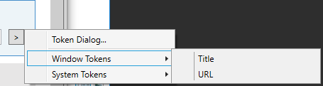

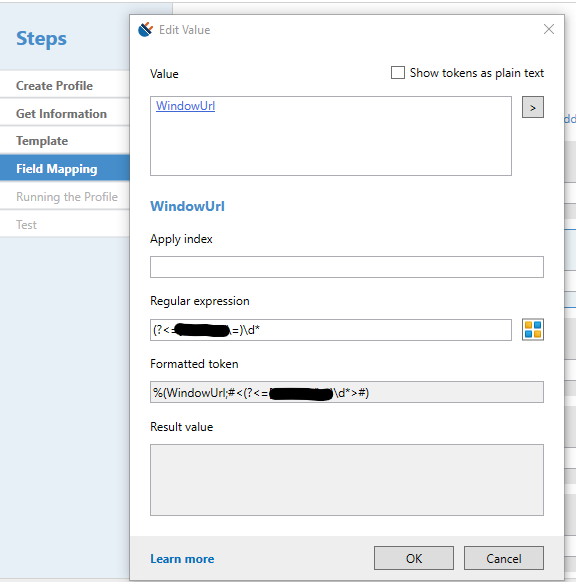

You can absolutely pull URL data out with Connector. We actually do that on a lot of our Connector profiles so we don't have to worry about remote-debugging or anything (this is especially important since we use IE Mode and you can't use remote-debugging with IE Mode).
What I do is create the profile with no Tokens set (i.e., configure the web app and URL, then delete any tokens it adds so you have none,
Then, you can use the Window URL token and regular expressions in the Token Editor to extract your identifier.

Jason, thank you!  I didn't think to look at Window Tokens... DUH!  That worked like a champ for Connector.  Now to see if there is a way to create a custom link in the Web Client directly.
