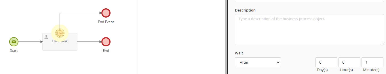

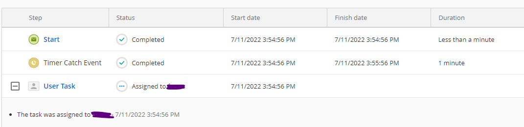

As far as I know, the timer should not terminate user task if its step history appears before user task. Following is an screenshot of a simple test instance:
According to the instance error, I would suggest review the outflow conditions of last executed step, which is 'Call Status Check Workflow' in instance history screenshot. Is any outflow can be taken in the terminated scenario?
If any step cannot proceed to next step, the entire instance will be terminated, and as a result the user task will be terminated.

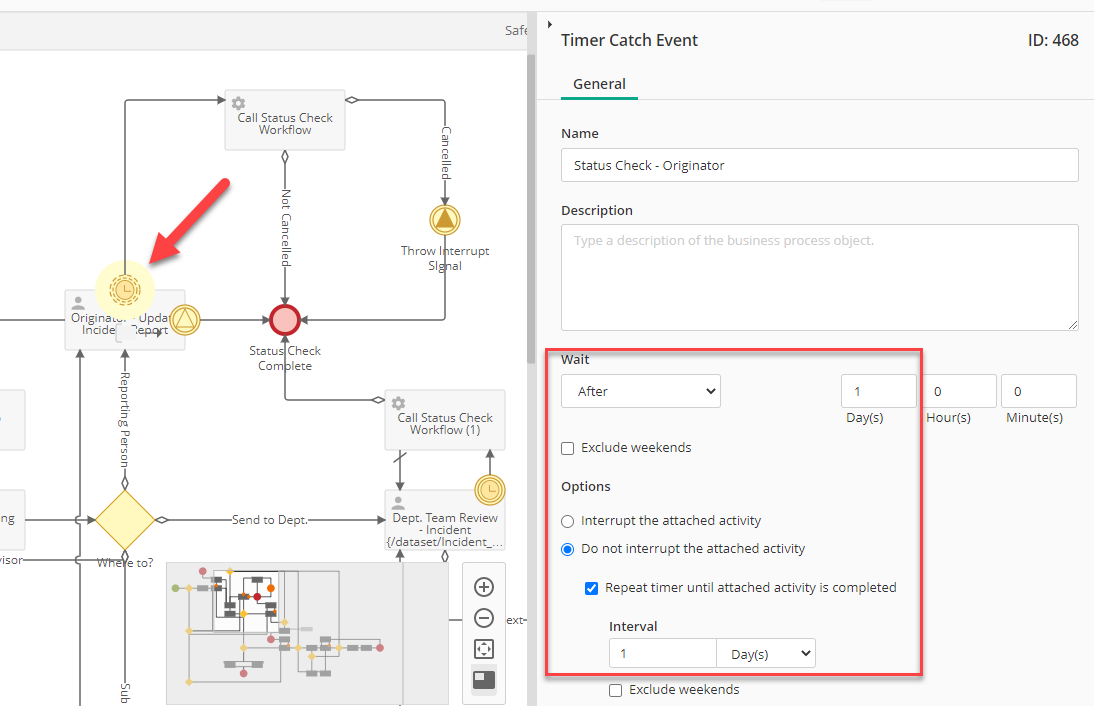

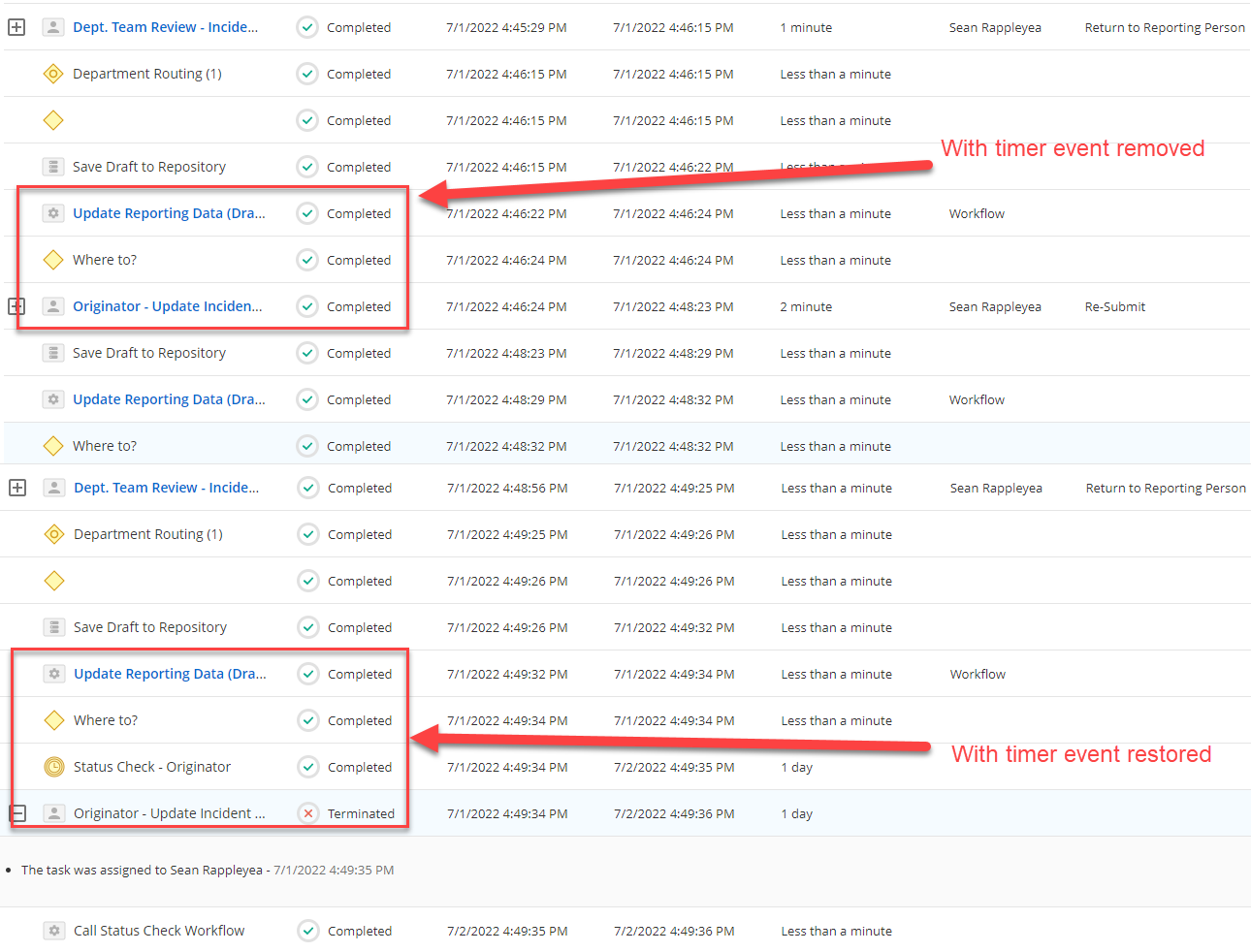

My most recent attempt at fixing this issue consisted of these steps:
  1. Delete the Timer Catch event on the Originator task
  2. Bring my test instance through the related user step WITHOUT the timer attached
  3. Verify that the timer didn’t show up in the Monitor history this time (it didn’t)
  4. Re-submit the Form to move it back to the ‘downstream’ administrative task
  5. Restore the timer event on the Originator task
  6. Send the task back to the originator again
  7. See if the timer event would behave itself this time (it did not – still terminated)
I am attaching screenshots of the timer event / configuration, as well as the Monitor history. If you have any thoughts on how I can fix this that would be really great, since I'm not feeling a lot of faith towards timer events right now.  Even if the answer is "you're an idiot, just change this little thing" I would rather feel stupid than have tasks that terminate whenever they hit a timer!

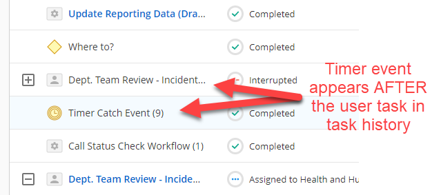

In addition, one of the reasons I suspect the timer is because it always shows up in the task history BEFORE the user task itself.  This isn't the case with other timer events, even within the same Forms process, as shown in the attached image.

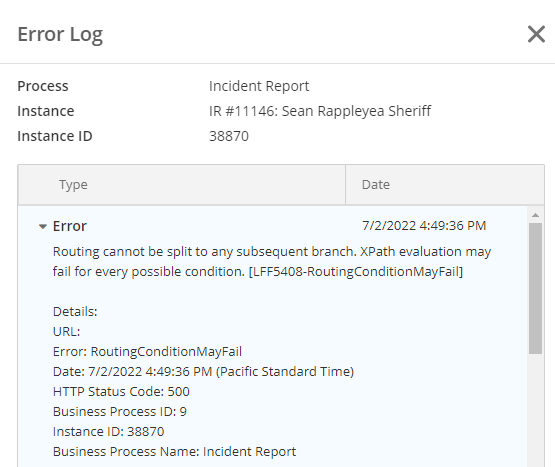

Here's a copy of the error log, though, per your request:
