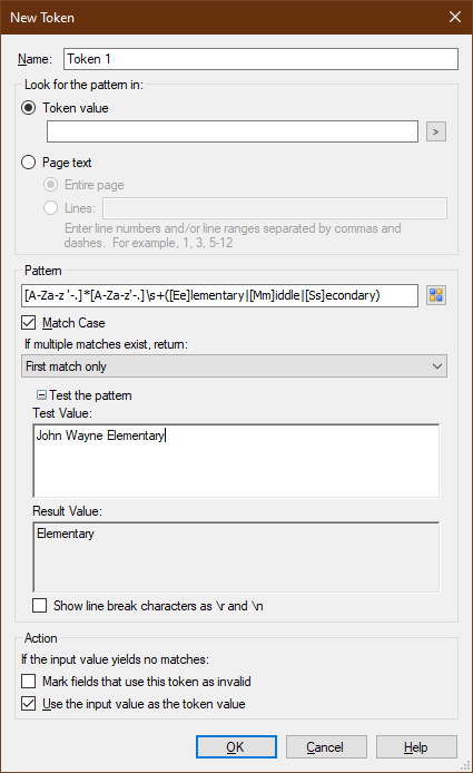

I've put together a regex that works in test environments (like regex101.com), but when I try to use it in Laserfiche I get a completely different result.
I'm looking to identify schools, and the schools all end with "Elementary", "Middle", or "Secondary"
"[A-Za-z '-.]*[A-Za-z'-.]\s+([Ee]lementary|[Mm]iddle|[Ss]econdary)"

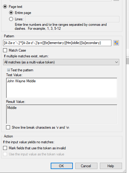

So, for example on regex101, that regex identifies the string "John Wayne Middle" perfectly.  However, in Laserfiche (when I use "Test the Pattern" or when I run a sample page through) it only resolves the word "Middle" from "John Wayne Middle".

The parenthesis are saying "return only what is in here" which is why you are only getting the word Middle when searching John Wayne Middle.
When I test on regex101 that's what I see there too:    See how Middle is flagged in green but the rest is not?
Perhaps try something like this:
[A-Za-z '-.]*\s+[Ee]lementary|[A-Za-z '-.]*\s+[Mm]iddle|[A-Za-z '-.]*\s+[Ss]econdary

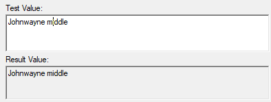

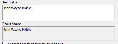

Weird, your original regex works for me:
Edit: Oh, wait, you're saying you want to read the "John Wayne" part, aren't you? That's because of the parentheses. They mark what you want extracted from the input value.

@████████ they got the same result as you.  They want the whole school name.  The capture group in the original is only for the last word "Elementary", "Middle", or "Secondary".

You only needed to turn the original capture group (parentheses) into a non-capturing group (question-colon parentheses).  I tested this and it works as desired.

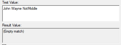

Why do you think you need nested non-capturing groups and the end-of-input anchor? In particular, having the end-of-input character could cause a match failure in some circumstances that you'd expect it to succeed (e.g., if there is any text after "Middle").
