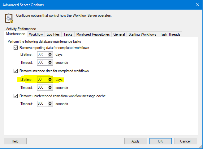

Is there a setting in the LF Admin Console or Workflow Administration to adjust how long the history is kept?

Mine are still at the default, so I haven't tested changes to this, but unless I'm mistaken, what you are looking for is in the Workflow Administration Console > Server Configuration > Advanced Server Options.

Workflow clears out instance data 30 days after an instance completes. That is the default setting. You can adjust that from the Workflow Administration Console. Upgrading would not have changed this value.
Be aware that extending the retention period for historical data may have an impact on the size of the SQL database used by Workflow.
