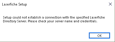

Is there a way to get more information about this error connecting to DS server during the installation of a LF product? I have scanned the network ports 5048 and 5049 and I am sure my credentials are valid. So not sure what to check next. It is not clear if it is a network or credential issue either.

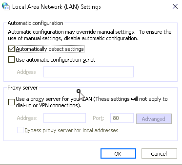

We get this error due to our proxy - we have to go into Internet Options and turn our proxy off in order to get a connection and license from our LFDS.
You might try that if your customer is using a proxy.
replied on June 21, 2022
Just checked to verify no proxy is configured for the LAN and I am using the LFDS server's direct IP address, not trying to connect to a proxy in any way.

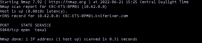

The App is on a perimeter network from the LFDS server.
Powershell Success
Nmap Success
This is why I wanted more info, the error does not appear to be a network outage

Also when you connect to DS, you can manually supply your domain credentials, but this throws the same error.

In my original post I assumed that the network is not the problem and the credentials is also not the problem. I still belive that is true because I have verified this. There is something else wrong and the error message does not supply the specifics.

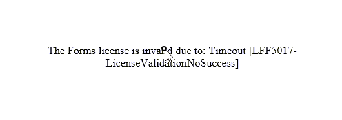

replied on June 23, 2022
It shows this error if you use the license file directly. Going to have to open a support case to get more information on the original connection error. If Forms requires communicaiton with DS, then DS communication issues must be resolved. But outside of making sure we have the right IP and the port is open, there is nothing more I can do.
