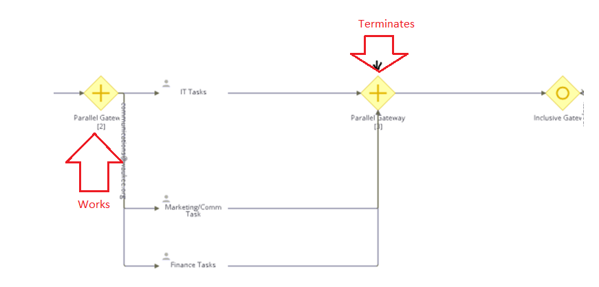

I can't tell from your screenshot entirely what is going on.  Can you share a larger view of your process - indicating which gateway is working and which one is failing?
Thanks!
replied on June 17, 2022
Hello Matthew,
Hope this is better :)
Jeff
So it's on the merge that it is failing, and it's talking about the task being cancelled.
I know there was an issue similar to this on version 10.2, but I believe that was with inclusive gateways, not parallel gateways - and by your tag it looks like they're working with version 11, so that probably isn't the issue.
Would they be willing to share a screenshot of the process history between the gateway that splits the paths and the one that merges them and suspends?

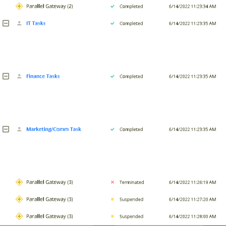

Hello Matthew,
Attached is the Instance History. I removed all of the account assignment information. The task are assigned to a Domain LF Account used to test their Forms:
Thanks,
Jeff
Nothing there is obviously an issue.
Darn.  I'm running out of ideas. sad
Based on this screenshot, I'm wondering if it's one particular task that it is terminating after.  Your screenshot only includes the start time of the user tasks, not the end time, so I don't know which task ended at 11:26:19 AM, but whichever one did is the one that appears to have led into the path that terminated.  I'm wondering if the other instances of the process terminated from the same path every time.  If so, then perhaps deleting the path between that task and the gateway, saving the process, and then recreating the path would be worth trying.  For that matter, you could delete all the paths into and out of that gateway, save changes, and then recreate them, just to be sure they are "clean".  You could also check out that particular form to see if there are possibly issues with validation or variables missing a name, etc.
