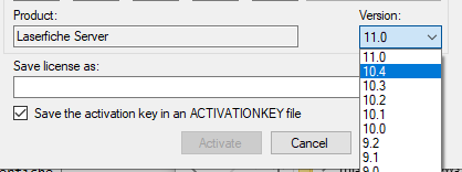

replied on June 16, 2022
When you renew, make sure you select the correct version for the application.  By default, the latest version (11) will be selected.
replied on June 16, 2022 • Show version history
I created an Activation Key on the website, and used that to update the Master License.  I don't see anything like what you showed there?
I updated the License on the Directory Server, should I be updating it in other locations?  I haven't had to do that before.

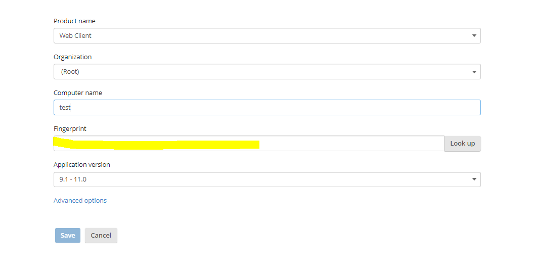

Sounds like you're using LFDS.  If that's the case, then try deleting the license on there and re-adding.  Make sure that the HWID matches to the server that the Web Client is on.
I did a lookup of the HWID (fingerprint), and it appears the same.  I've deleted the license and re-added it, but no luck.  Same issue persists.
I'm kind of stumped as to why this is so much more difficult than last year.  I remember it being a pretty straight forward process, primarily updating the Master License on the LDFS server.
