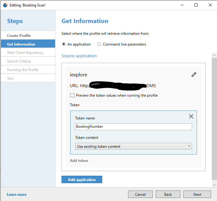

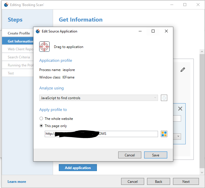

Below is the old IE configuration I am trying to mimic:

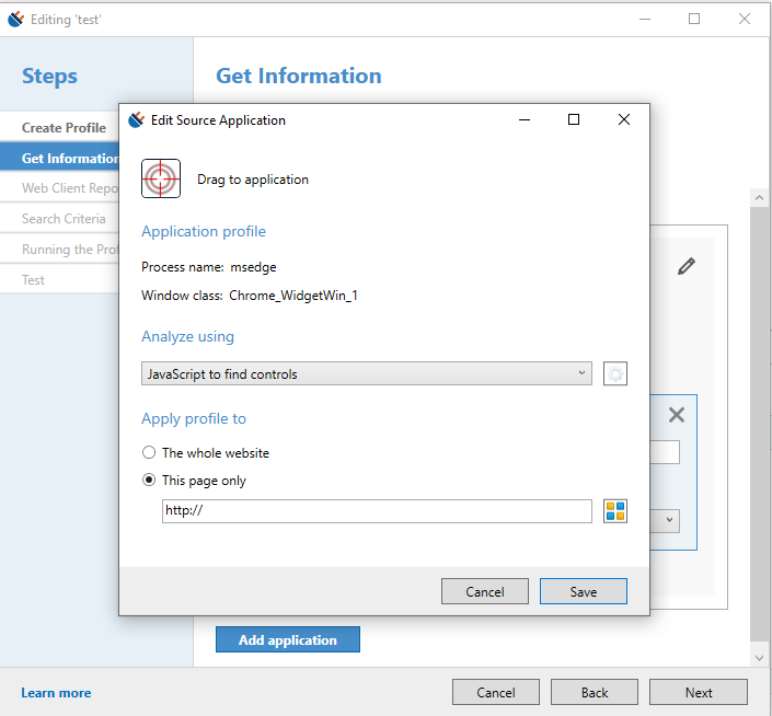

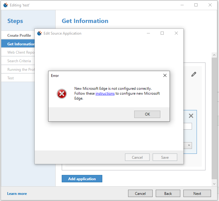

Edge seems to have no ability to read the URL:
I am only ever able to get Connector to see and work with Edge if I select let UI automation to find controls.  Has anyone come across similar issues with Edge specifically with IE mode?  Thank you in advance

Unfortunately, IE Mode and JavaScript controls are mutually exclusive.
In order for JavaScript to work with Connector in Edge or Chrome, you must enable remote debugging, however, remote debugging cannot be used in combination with IE Mode.
As a result, you cannot use both of these together.
