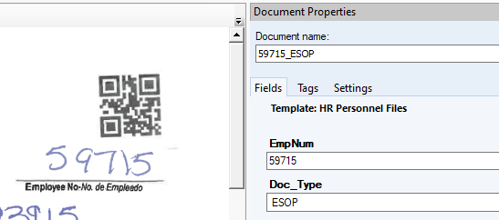

Our HR folks decided to start printing QR codes on certain forms in order to scan them in Quick Fields.  In the following example I can read the QR code with my phone but Quick Fields is not reading it.  I can see that there are other possible things in the image that could interfere if it were a standard bar code, but if my phone can read it, shouldn't Quick Fields be able to read it?

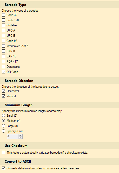

1) Make sure your Barcode process is configured to look for QR codes (it's not, by default)

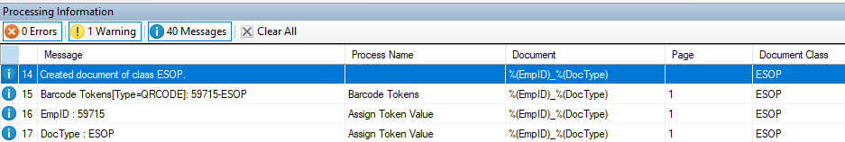

2) The processing results you're showing me are not from clicking the "Test current process" link (my mistake, failing barcode output looks really different from the successful output, so I was confused)

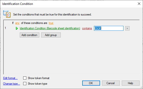

3) There's something off about your barcode zone name... it should be the same between the Region Selection and the Identification Condition.  Try re-selecting the token in the condition editor.

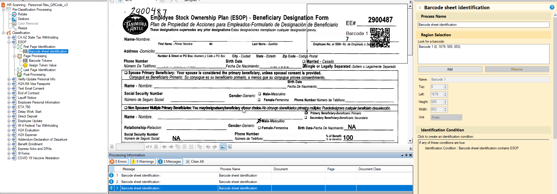

I removed the bar code zone for this new test so it should try to read from the whole page.

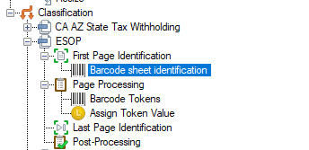

I've selected QR Code only:
I've selected Bar code sheet identification:
I clicked on Test current process and it gave me blank result for the bar code:

#3 looks good to me; I realize there was a discrepancy when I had a bar code zone added for just that region on the right side of the document, but I removed it for that latest test.
