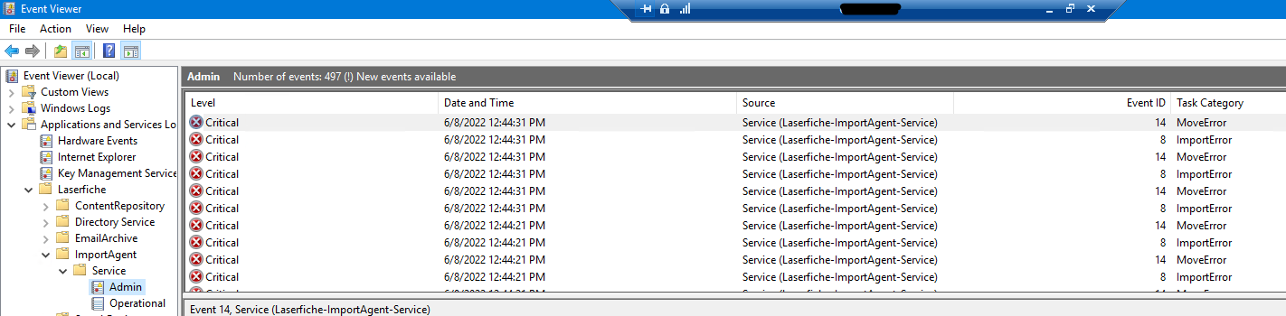

It sounds like you are trying to get the logs from the Event Viewer not from Audit Trail.
Event Viewer is a Windows program.  If you access it on your server that is running Import Agent, you should be able to find the Import Agent event logs there.
This is a screenshot from my server showing a bunch of errors because it's trying to import a file that the user still has open.
