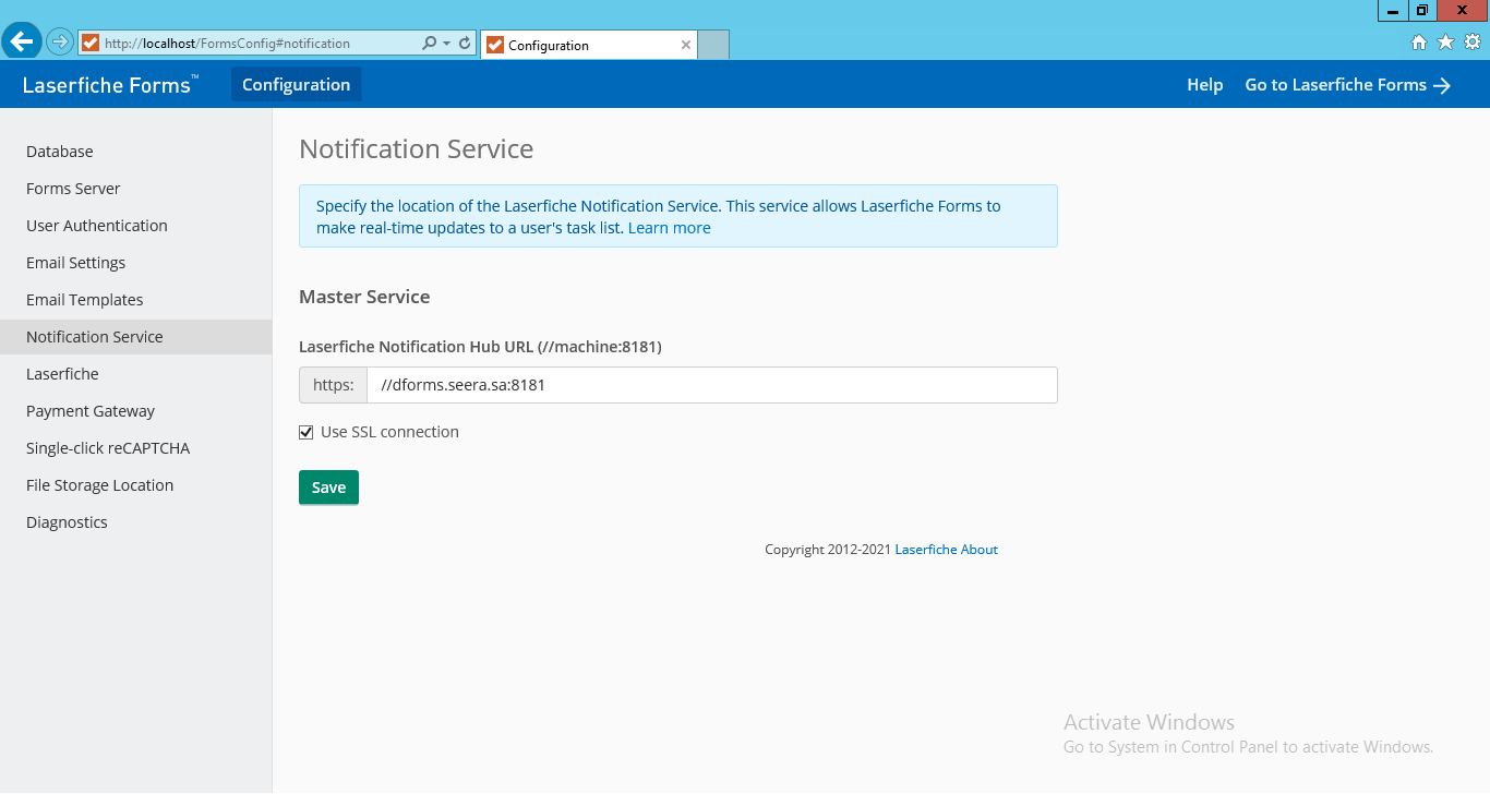

Configurations in Laserfiche Forms were also set as below. No errors or issues are found in Event Viewer of Forms Operational or LFNotificationService. We are able to see last message that "Master service initialized."

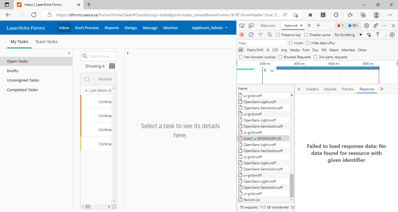

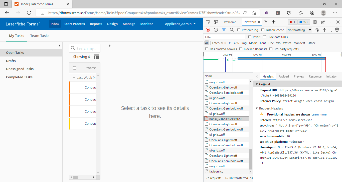

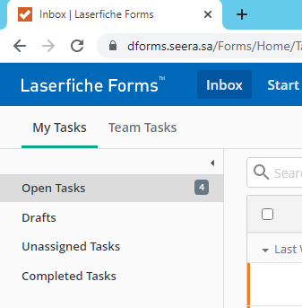

What's happening is that notifications are working when we browse forms URL on server as we can see the notification numbers beside open tasks. But when the same forms URL is browsed from outside of the server, notifications does not work. Based on our findings from browser network traffic (by F12 option), one of the URL (https://dforms.seera.sa:8181/signalr/hubs?_=1653902459120 ) is not accessible when we browse from outside of the server.
On the server, notifications work.
Outside of the server, notification doesn't work. We are seeing below error in network traffic of the browser.

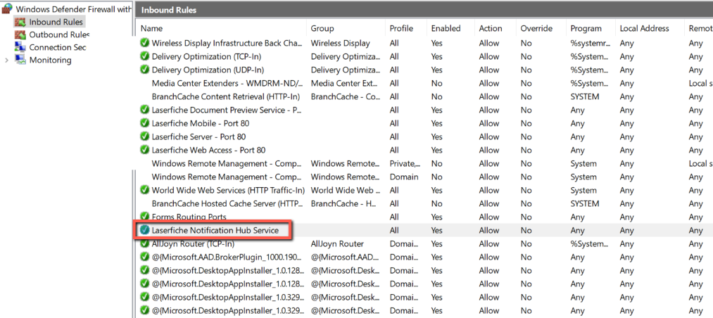

If it works on the Forms server itself but does not work when outside the server, you can check the firewall configuration, the port 8181 may not be opened. Please check from the Windows Firewall Inbound Rules, whether there is a rule with name "Laserfiche Notification Hun Service" with TCP port 8181(this should be added automatically when install Forms)
replied on May 30, 2022
According to the network team, 8181 port is opened and already listening but still the same issue.
There is a DMZ setup here. Shouldn't this port be opened from DMZ side as well?
