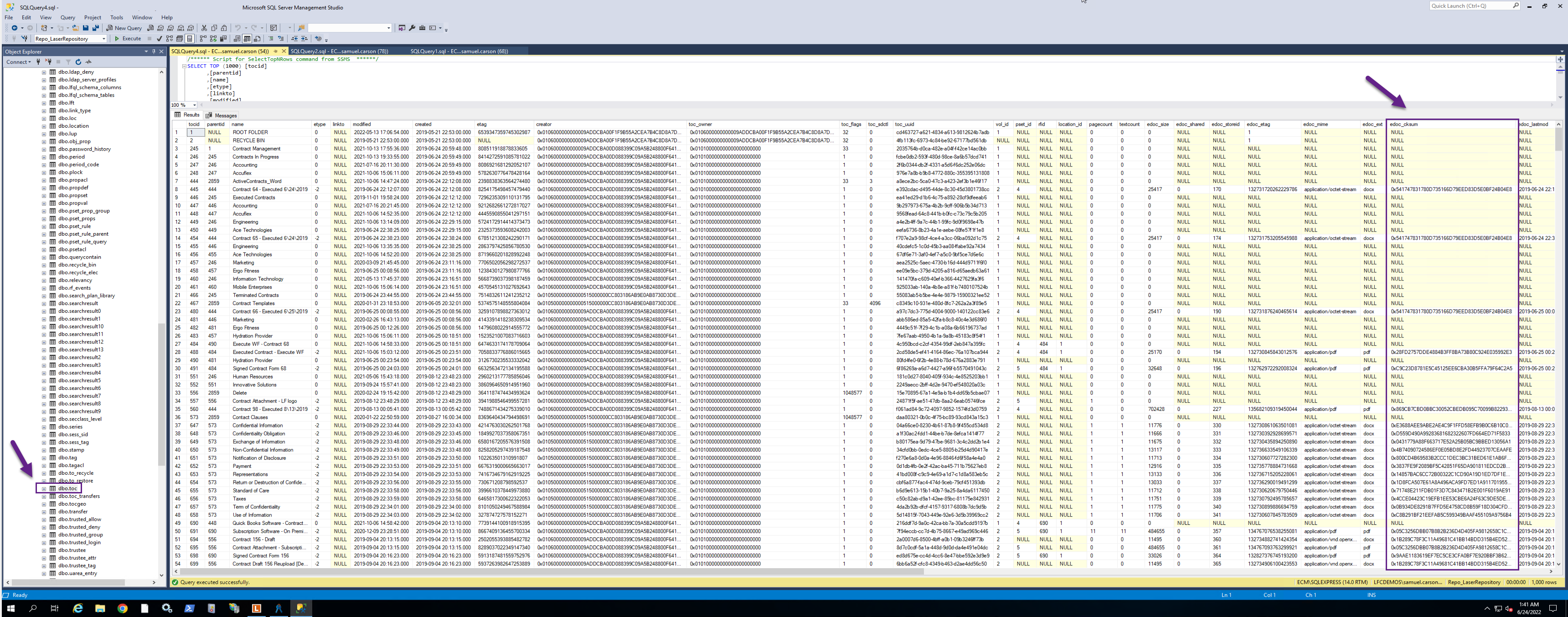

My apologies for the very delayed response. You can find the SHA-1 checksum values in the dbo.toc table under the edoc_cksum column. The toc value is the Entry ID. Please note that you'll only see edoc_cksum values for "electronic documents", i.e., non-image (Laserfiche page) files. Image checksums are in the dbo.doc table but if you're doing TIFF page generation (vs say importing a single png or jpeg) those checksums won't match the "source" because pages are usually Laserfiche-generated files generated from what you import.
