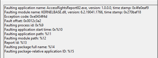

replied on July 21, 2022
Hi Brian
There is no visible error in the UI, it just launches and then disappears.
The recorded error in the event viewer is this:-
Cheers!
Chris Douglas
replied on July 25, 2022
Chris, have you tried what Brian suggested and run the SDK redistributable installer first? And do you have the Laserfiche Windows Client installed on the machine you're trying to run the utility from? It requires the Windows Client.
