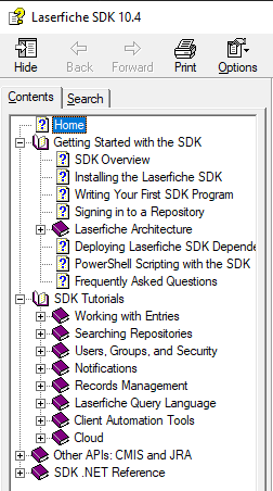

For basics, the Getting Started with the SDK and SDK Tutorials sections of the SDK104.chm documentation file are solid and my go-to source for the fundamentals. Note that the LfSDKNet104.chm file does not have this getting started/tutorial section.
Then to relate that to using SDK Scripts in Workflow, Workflow gives you a pre-made Session object based on the repo connection profile, as well as an Entry object based on the bound (usually starting) entry, and some additional classes and methods to get and set Workflow tokens.
