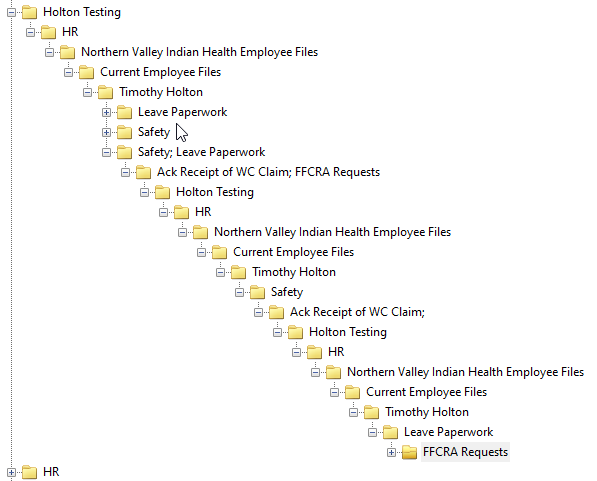

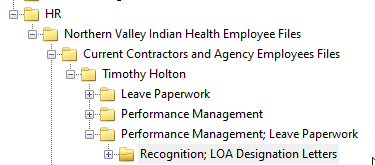

[ROW()] works flawlessly on the name of the File Upload but just descends into madness on the File Upload path. If I try to do it with tokens for each section I end up getting folders named after every item in the field, if I have a workflow build the path and add it as a field in the collection it breaks and then suddenly I have a folder path that has each individual word as it's own folder with the next word nestled inside.
I would love some help on this because I keep looking it up and just keep finding "Use [ROW()] !" but it doesn't seem to work for me.
Below are examples of what's happening. The first is using \{/dataset/Are_we_testing_this_process_}\HR\Northern Valley Indian Health Employee Files\{/dataset/Where_should_these_Employee_Files_be_stored_} Files\{/dataset/Full_Name}\{/dataset/Documents_Import_Section/Catagories[ROW()]}\{/dataset/Documents_Import_Section/Document_Type[ROW()]}\ in the File Upload Path and the second when I used a token passed to the form from Workflow, \{/dataset/Are_we_testing_this_process_}\{/dataset/Documents_Import_Section/File_Location[ROW()]}

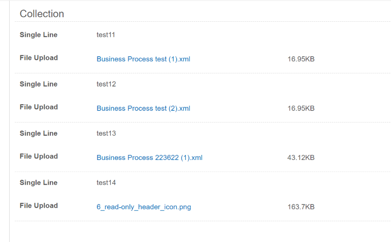

I checked with Forms 11 with a simple form as following:
And set the path for the files inside collation with "\{/dataset/_bp_process_name}\{/dataset/Collection/Single_Line[ROW()]}\" in the save to repository servive task properties.
The folders the save to repository service task created are as following:

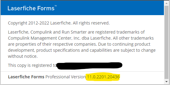

replied on May 24, 2022
How do I check my forms version?
@████████ click your name in the top-right while in Forms, then click "About" and the version will be listed at the bottom of the pop up window.
There we go, 10.4.1, getting ahold of my VAR for an update
