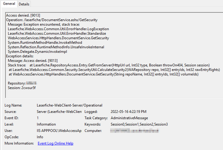

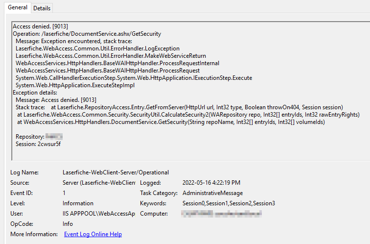

I am seeing the following two errors in my Laserfiche-> WebClient-> Server-> Operational log and am wondering if someone can point me to what I need to be checking to resolve the error?
replied on May 16, 2022

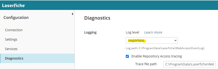

Change the log level in the configuration page to avoid having these informational errors show up in the event log:
To add to this, Laserfiche Server throws error code 9013 when someone tries to access something within an repository they don't have permission to do. For example, attempting to open a document they have Browse but not Read permissions on.
Like Robert mentioned, it's an informational message that a user encountered said error. Not something to "resolve".
Is the logging level able to be changed in a config file?
Yeah, it's in "C:\Program Files\Laserfiche\Web Access\Web Files\Config\WebAccessConfig.xml" under node:
<LoggingOptions>
    <EventLogLevel>CRITICAL</EventLogLevel>
replied on May 17, 2022
The log level in the WebAccessConfig.xml file is already set to CRITICAL.
Are you seeing a lot of these errors? They shouldn't be showing up unless the log level is Informational or Debug.
The event log messages at Informational/Debug log level can be ignored, they do not represent actual errors and are there for debugging purposes.
