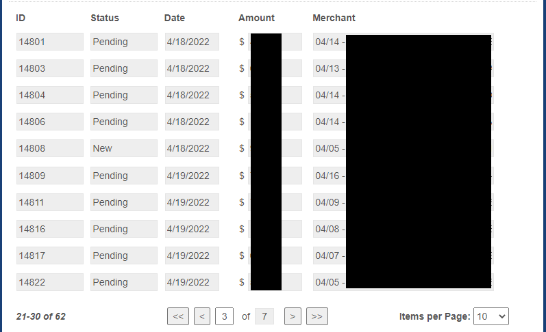

Step 2 - In Forms, add the following fields to your form. The labels do not matter because the fields are going to be rearranged/hidden by Javascript.
- Drop-down field. Leave it editable. Add choices like (10, 25, 50, 100, 250, 500). Set 10 as the default value. CSS Class Name (and variable name): page_size
- Number field. Leave it editable. Zero decimal places. Thousands delimiter off. Default value of 0. Formula: =((current_page-1)*page_size) CSS Class Name (and variable name): hidden_field_start_row_index
- Number field. Leave it editable. Zero decimal places. Thousands delimiter off. Default value of 0. CSS Class Name (and variable name): hidden_field_total_record_count
- Number field. Leave it editable. Range allowed 1-9999. Zero decimal places. Thousands delimiter off. Default value of 1. CSS Class Name (and variable name): current_page
- Number field. Mark it read-only. Range allowed 1-9999. Zero decimal places. Thousands delimiter off. Default value of 1. Formula: =ROUNDDOWN((hidden_field_total_record_count)/page_size)+1 CSS Class Name (and variable name): last_page
- Add any other fields for the search parameters you included in your stored procedures.
Step 3 - Add your table to the form, formatting it as you desire.
Step 4 - Add a custom HTML element below your table.
<div style="padding-bottom:8px" id="tableFooterPagination">
<div style="display: inline-block; width: 18%; text-align: left" id="tableFooterCurrentRange">
<b><i>0 - 0 of 0</i></b>
</div>
<div style="display: inline-block; width: 52%; text-align: center" id="tableFooterNavigation">
<div style="display: inline-block; width: 18%;">
</div>
<div style="display: inline-block; width: 6%;">
<button type="button" id="tableFooterNavigateLeft2">
</button>
</div>
<div style="display: inline-block; width: 1%;">
</div>
<div style="display: inline-block; width: 4%;">
<button type="button" id="tableFooterNavigateLeft1">
</button>
</div>
</div>
<div style="display: inline-block; width: 10%; text-align: center" id="tableFooterNagivateCurrentPage">
</div>
</div>
<div style="display: inline-block; width: 2%; text-align: center">
of
</div>
</div>
<div style="display: inline-block; width: 10%; text-align: center" id="tableFooterNagivateLastPage">
</div>
</div>
<button type="button" id="tableFooterNavigateRight1">
</button>
</div>
</div>
<button type="button" id="tableFooterNavigateRight2">
</button>
</div>
</div>
</div>
<div style="display: inline-block; width: 18%; text-align: right" id="tableFooterShowItems">
<b>Items per Page: </b>
</div>
</div>
Step 5 - Set-up lookups to populate your table and the total count from the two Stored Procedures you added in step 1.
Step 6 - Add Javascript to the form to rearrange the fields and manage the navigation of the table pages.
//Changes to the form layout when it is loaded to facilitate the table footer.
$('.page_size').hide();
$('.hidden_field_total_record_count').hide();
$('.current_page').hide();
$('.last_page').hide();
$('.hidden_field_start_row_index').hide();
$('.page_size select').insertAfter('#tableFooterShowItems').addClass('page_size_select');
$('.page_size_select').css('width', '7%');
$('.current_page input').appendTo('#tableFooterNagivateCurrentPage').addClass('current_page_input');
$('.last_page input').appendTo('#tableFooterNagivateLastPage').addClass('last_page_input');
$('.current_page_input').css('text-align', 'center');
$('.last_page_input').css('text-align', 'center');
$('.current_page_input').css('width', '100%');
$('.last_page_input').css('width', '100%');
//Set the current page field to a max of the last page field.
$('.last_page_input').change(function() {
$('.current_page_input').attr('max', parseInt($('.last_page_input').val()));
//Reset the current page to 1 if the page size is changed.
$('.page_size_select').change(function() {
$('.current_page_input').val(1).trigger('change');
//Function that can be called (and re-called as needed) to set-up and manage
//the tableFooter for navigating the table details.
function UpdateFooterDetails()
var startIndex = parseInt($('.hidden_field_start_row_index input').val()) + 1;
var endIndex = parseInt($('.hidden_field_start_row_index input').val()) + parseInt($('.page_size_select').val());
var totalCount = parseInt($('.hidden_field_total_record_count input').val());
if(endIndex >= totalCount)
endIndex = totalCount;
var newHTML = '<b><i>' + startIndex + '-' + endIndex + ' of ' + totalCount + '</i></b>';
$('#tableFooterCurrentRange').html(newHTML);
if(parseInt($('.current_page_input').val()) == 1)
$('#tableFooterNavigateLeft2').attr('disabled', 'true').css('opacity',0.5);
$('#tableFooterNavigateLeft1').attr('disabled', 'true').css('opacity',0.5);
else
$('#tableFooterNavigateLeft2').removeAttr('disabled').css('opacity',1);
$('#tableFooterNavigateLeft1').removeAttr('disabled').css('opacity',1);
if(parseInt($('.current_page_input').val()) >= parseInt($('.last_page_input').val()))
$('#tableFooterNavigateRight1').attr('disabled', 'true').css('opacity',0.5);
$('#tableFooterNavigateRight2').attr('disabled', 'true').css('opacity',0.5);
else
$('#tableFooterNavigateRight1').removeAttr('disabled').css('opacity',1);
$('#tableFooterNavigateRight2').removeAttr('disabled').css('opacity',1);
//Trigger the update of footer details when form loads and when lookups are complete.
UpdateFooterDetails();
$(document).on('lookupcomplete', function() {
//Change the page number when the page navigation buttons are clicked.
$('#tableFooterNavigateLeft2').click(function() {
$('#tableFooterNavigateLeft1').click(function() {
$('.current_page_input').val(parseInt($('.current_page_input').val()) - 1).trigger('change');
$('#tableFooterNavigateRight1').click(function() {
$('.current_page_input').val(parseInt($('.current_page_input').val()) + 1).trigger('change');
$('#tableFooterNavigateRight2').click(function() {
$('.current_page_input').val(parseInt($('.last_page_input').val())).trigger('change');
The end result should look something like this:
