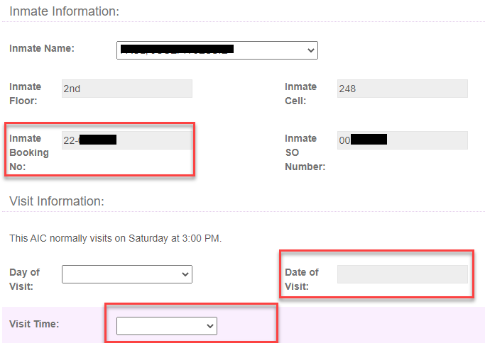

We recently upgraded to Forms 11 (11.0.2201.20436).  While investigating a customer complaint, I discovered that Forms 11 seems to be FAR too enthusiastic about trying to run lookups.  In this particular Form, I have a lookup that runs based on the values of the three indicated fields:
As soon as I select an inmate to fill the first field, the lookup runs.  Rather than getting a result based on a particular date and time, the hyperactive and eager-to-please lookup just returns values based on ANY date and time.  This is not good!  I can think of two ways to bypass this effect:

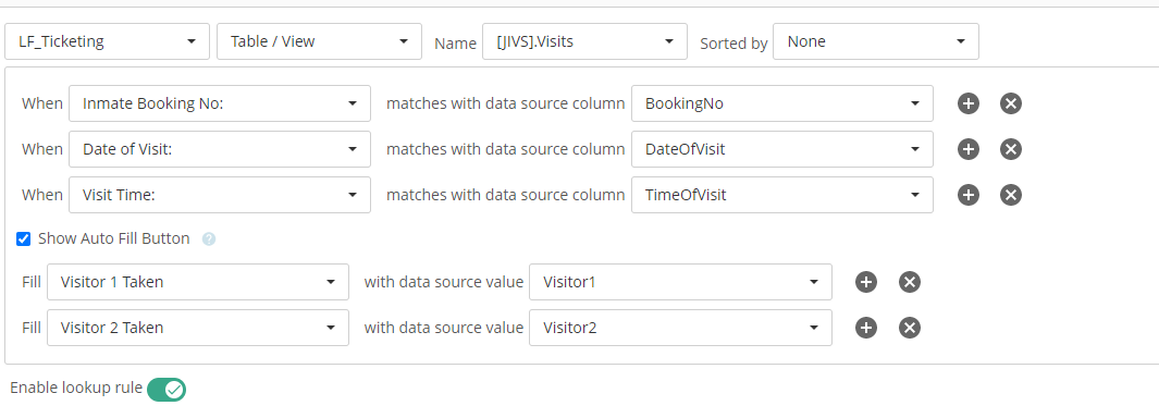

Is this using the classic or modern Forms designer? Can you post screen shots of your lookup rules?
replied on May 16, 2022 Show version history
We are using the classic designer.  We have ended up using at least a little bit of javascript on every single Form we're using, so the new designer is a no-go for us for now.  This Form has a total of 14 lookup rules; should I post all of them?
Here is the lookup rule in question (I currently have the auto-fill button option selected as a bypass):

Could you also provide details on how trigger fields 'Inmate Booking No:', 'Date of Visit:' and 'Visit Time:' are filled? For instance, are they filled by another lookup rule?
Also, do you have any custom JavaScript to trigger lookup rule?
I was trying to recreate the issue but no success. The lookup rule does get triggered whenever one of trigger field changes, while doesn't return result regardless of value in other trigger fields.

Ziyan Chen I think you might be on to something here.  Probably what Blake Smith was going for as well.  These fields are all populated by lookup rules; the process is supposed to go like this:
Form opens -> lookup rule populates inmate selection from live data -> Based on Inmate Selection, options for Visit Day and Visit Time are populated -> When Visit Day is selected, Javascript calculates the date and populates the 'visit date' field -> some combination of Inmate, Visit Date, and Visit time used in multiple lookups
While I'm not sure why it's triggering without the Visit Date having been updated yet, it's probably significant that other primary fields are being populated, even though nothing is actually selected.
I'll take a closer look at the javascript.
