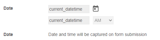

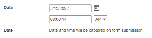

When a date/time field is set to current date/time,
  1. Not read-only populates the "current" date/time when the form first loads
  2. Read-only populates on submission
