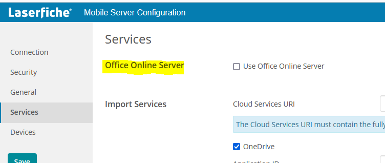

By WOPI, I am referring to Office Online Server. Did you enable the following option on Mobile Server Config? If yes, the LF app will open the word doc in an embedded webview directly. Otherwise, it would download the file and then try to open it with other existing apps.

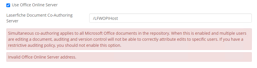

I tried and it said invalid online server address. Do I need office 365 for this to work? I'm pretty sure we don't have Office 365.
Of is this something I need to install from the LF installer?
