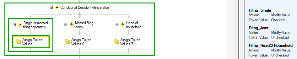

I'm using conditional decision to set token values for filing_single, filing_headofhousehold, or filing_joint on the W4 form.  The conditional decision is working:
The tokens are getting set correctly:

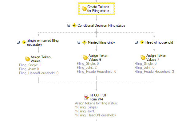

I added the XML file in the specified folder and updated the workflow to use the values you specified (0 for unchecked, 1, 2, or 3 for checked depending on which box is being checked).  It is still checking all three boxes on the W4 form.  Do I need to restart the workflow service for this to take effect?

This workflow works for me:

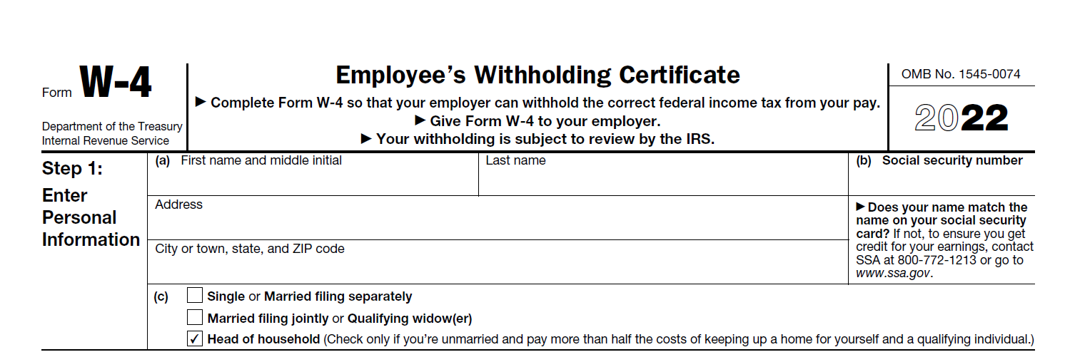

resulted in

Your example is essentially what I'm doing.
It looks like it's going to work, but the values aren't assigned in the PDF check boxes correctly.  I unlocked the W4 and looked at the check box Options tab and each one is assigned an export value; 1 for the first box, 2 for the second box, and 3 for the third box.  So I think we' re passing the right values.  I just don't see the expected results.

Actually, I think it's working now.  I replaced the original w4 in my workflow with the unlocked version and now the values appear to be updating as expected.
