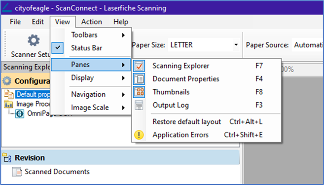

When scanning into Laserfiche in Standard Mode, our Clerk indicated she was no longer able to see thumbnails.  The document would appear in the Image Pane, but there would not be any thumbnails shown in the Thumbnail Pane, and the Revision Pane would not show any document details.  She did have "Thumbnails" selected in the View and Panes menu.

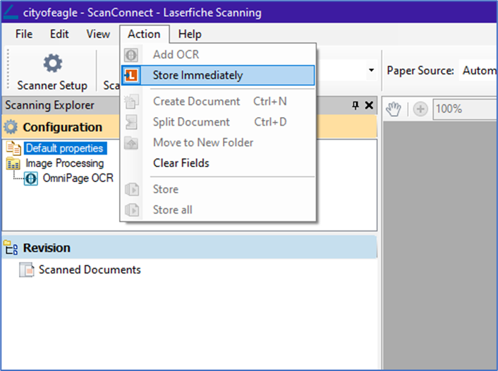

I was able to duplicate her issue in the Standard Scanning Mode, by going into the "Action" menu, and checking "Store Immediately".
I had her go into her "Action" menu, and "Store Immediately" was not selected.  I thought I had failed to find a solution for her, but on the off chance it would help, I had her select "Store Immediately", and go back in and deselect it, then try a scan.  She was able to see her Thumbnails, and the revision pane was back to the way it had been before (the way she wanted it to be).
