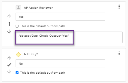

BP Process:

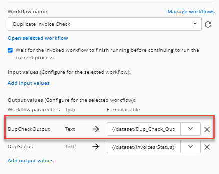

Process Automation Workflow:
If a duplicate is found, I capture the entry ID and URL to re-display back in the form during my AP Review step and also update a DupCheck Output token that I use in a conditonal gateway to send my flagged instances for review.
