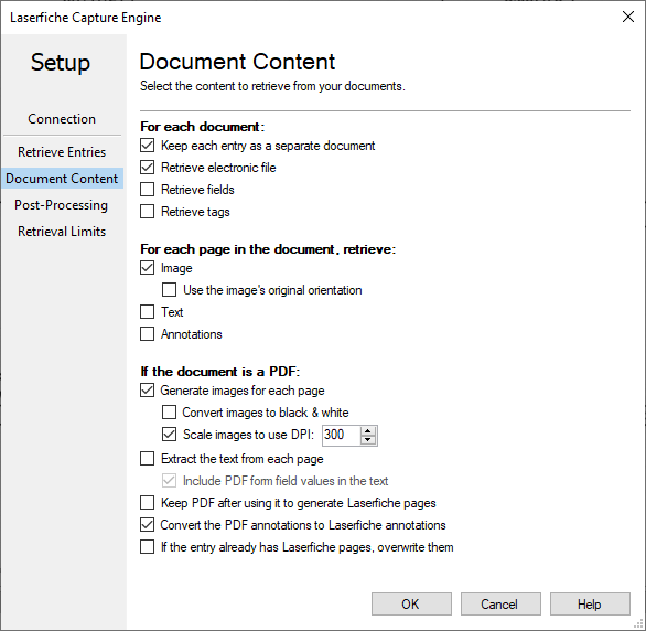

Here are the settings for the Quick Fields session:

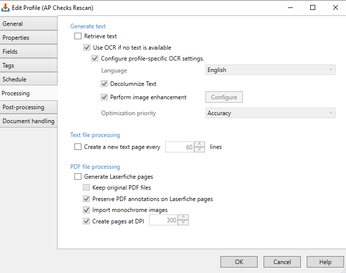

As a test, I downloaded the PDF and ran it through Import Agent with the following settings and then ran it through Quick Fields successfully:

Please try checking the "If the entry already has Laserfiche pages, overwrite them" checkbox before you open a support case because that is likely the cause (e.g., the PDFs may have had text pages generated when they were imported, without image pages, so no image pages are being generated in QF).
replied on April 25, 2022
That appears to have done the trick.  It was just confusing to consider that option since the PDF wasn't created by Laserfiche and my thought process concluded that it wouldn't have Laserfiche pages to overwrite!
