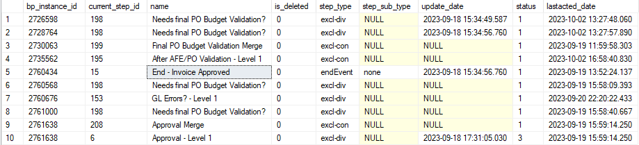

replied on April 20, 2022
Yes, the instance information came from that thread. Here is a screenshot of the results:
