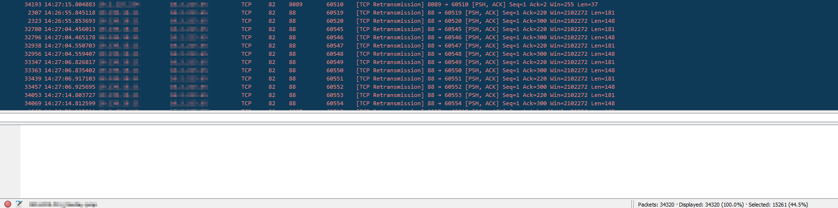

As part of troubleshooting a separate issue I had our network engineer run a packet capture on our LFDS server just to see if there were any issues with the network. I'm no expert when it comes to dissecting a packet capture but what I saw shocked me. It appears there's a retransmission rate of 44.5% (see attachment) which is something I've never seen before.
From what I understand a 3% retransmission rate is normal and a rate of 5% to 8% will have a noticeable impact on response times. With a rate of 44.5% it's a wonder the LFDS is functioning at all.
It is happening across all VLANs, all ports and all protocols for both local and wide area networks. LFDS (5048 & 5049) LDAP, RDP, SQL Server, Splunk: High retransmission rate for all of them.
This makes sense, as packet loss should be a physical problem, not a software problem. The services shouldn't even be aware of the packet loss and re-transmissions. In the end they receive their response as the network layer is handling packets being lost due to interference.
You should be able to troubleshoot this entirely without any Laserfiche software invovled, by checking the packet loss between where the server endpoints are using any device. A small linux based test device should reproduce the same issue.

Turns out it was an artifact of how the packet capture was done. Because it was capturing traffic across two VLANs it was somehow capturing packets twice and Wireshark didn't know how to parse that. That's why there were so many duplicates and retransmissions. Sorry for the bother!

Come to think of it I might not have actually put in a ticket. Tom Lappas is working with us. Turns out we found out what the problem with the PCAP was. It was an artifact of how the packet capture was done. Basically it was capturing some of the packets twice because it was capturing traffic across two VLANs and Wireshark kept seeing those as duplicates/retransmissions.
