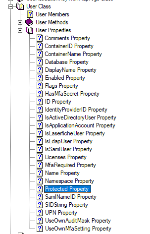

@████████, I'm out of office until May starting tomorrow so I unfortunately can't assist further myself in the immediate future. You should be aware that there is an "Exempt from synchronization" flag for user accounts. When you manually add a user in the LFDS Web Admin UI, this flag is automatically set. In LMO, it's the "Protected" property ("Whether or not the user object is exempt from modification by AD synchronization") of the User class, and those classes that inherit from it like SamlUser. I'm guessing that's the problem.
replied on April 13, 2022
Yes.  I observe in LFDS dbo.directory_objects.flags I have it set to 4 for the SAML user programmed addition using LMO and 20 for the user I add manually.
This would appear to be the difference.  I will wait for your return and reply for what can be done including and unsupported update to the directory_object added to change the flags to 20.
