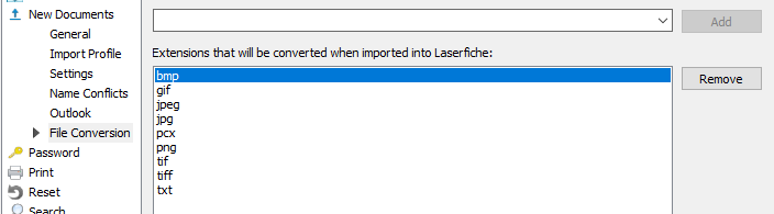

Hello,
We have a customer who has removed all of the extensions from User's LF Windows Client->Options->File Conversion settings, but they have found that documents were brought in by some of these users with the extensions converted and when they checked their option settings, they showed the extension listed again.
Customer believes the user(s) did not add them back in.
If it was not human interaction, what would cause this extensions to show in the list again??

I tested removing all extension and ran a repair of my LF Windows Client, but that did not add the extensions back in.
I know these can be set in the Web Client, but customer states users only use the LF Windows Client

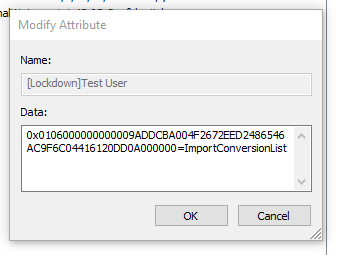

So I tested this on my system with my "Test User" setting the attribute as follows in the "Everyone Group" but the Test User can still access the File Conversion list and add/remove extensions.
I think I set it right. The SID was pulled from the dbo.trustee table for the user.

The way I read the documentation, there are only 5 "Categories" that can be used.  Per the link from @████████ above:
The following settings categories can be locked down:
  • SearchSettings
  • DocViewPanes
  • AnnotationStyle
  • QuickSearch
  • AdvancedImport
In your Lockdown attribute, you list "ImportConversionList" and that is not one of the 5 "Categories".  Try using "AdvancedImport" instead of "ImportConversionList".
replied on May 10, 2022
I think you want the string representation of the sid, which would be something more like "S-1-x-y-z".

So given the SID format, I take it this can only work for Windows Accounts?
The SID format I used was pulled from the dbo.trustee table in SQL.

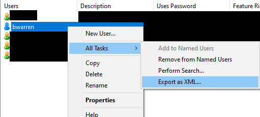

In the same documentation that @Brian McKeever linked to has a line that tells you how you can get the user/group SID.
The SID of a user or group can be obtained by exporting the trustee definition; the SID is listed in the resulting XML.
replied on May 11, 2022
Bert-Thanks...now just need to figure out how to do that wink
Jeff

Thanks Bert and Brian
With both of your help I was able to use the AdvancedImport option with the SID for the test account and now the option to add file extension is greyed out.
