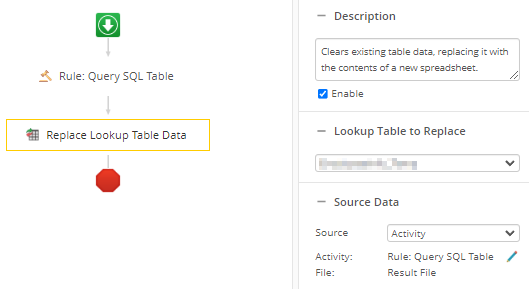

I'm sure I'm missing something probably easy, but I can't seem to figure this out. I have a Powershell script that polls Active Directory every hour and exports all users to a CSV on my PC. I've created an External Data Source in Laserfiche and pointed it at this CSV, then created a Query Rule to Select the data from the Users table. Next, I created a lookup table and populated it with the same CSV to use in a lookup table rule of my form.
What I'm trying to do, and can't seem to figure out, is create a workflow that will run regularly and update the Lookup Table with the information read from the External Data Source.
I created a simple workflow of "Run Rule (Query the Users table in Data Source) -> Replace Lookup Table Data (Source Data is "Activity -> Read Rule Results File").
When running the workflow, Run Rule runs fine but Replace Lookup Table errors with "Bad Request Status: 400 Response: "DM81303: Could not parse file as CSV file"". I'm not sure where to look to fix this and in Cloud I don't have any CSV options in workflow.

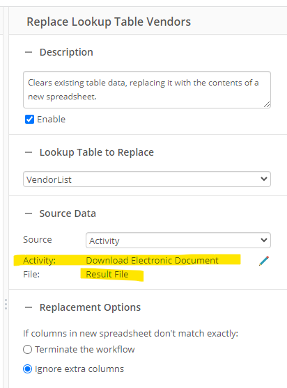

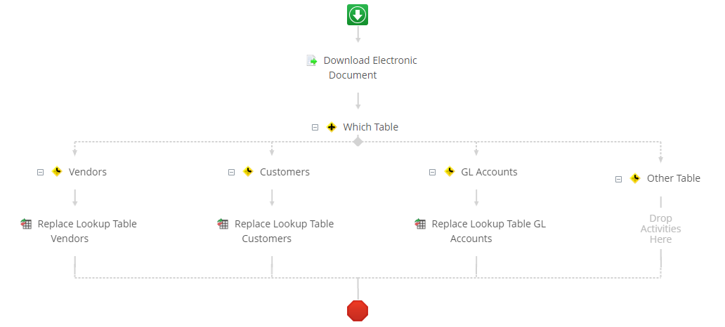

replied on October 4, 2024
I didn't see anyone post this so I thought I'd help the next guy. I ran into this error as well, and realized that I needed to use the 'Download electronic document' first, and then that shows up in the activity for the 'replace lookup table data'. Worked great after that.

replied on April 8, 2022
DataQuery rule's query result is in kind of a ADO.net SQL table format.
[Activity -> Read Rule Results File] is  a XML serialization version of the above format data, which is NOT the original CSV file in your machine. But what [Replace Lookup Table] expects is the CSV format, so it throw the "Could not parse file..." error.
So the use case here is to automatically upload a csv file to update/replace lookup table. DataQuery rule is not the mechanism to address that.
Does Chad Saar's work for you?
