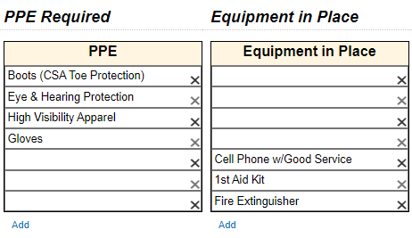

I have two tables side-by-side, filling lookup values from the same SQL table, and I'm getting extra rows because of null values.  How can I get my tables to fill without the null values?

Thanks, James.  Unfortunately, although I was learning about using views in lookup rules last week, I discovered that this particular form needs more flexibility than the views can give me.  Each table is filled based on which task was picked.  ie, if Task #324 was picked, then load all of the #324 rows.
This is the same form today, but a different table, however, there is still the need to isolate the rows based on which task was picked.  For each task, the hidden SQL tables have different hazards, different PPE and different ... well ... a lot of different tables with collections of things.
I guess I could create a different SQL table for each different thing, but I was combining things where possible.  In this case the SQL table holds two categories of things (PPE, and IN PLACE) and the tables load based on which category was picked.  But it needs to pull in only the PPE or IN PLACE items for the right task.

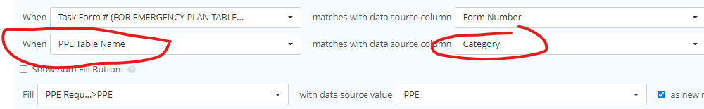

Oh!  I figured it out!  I had to have another hidden field to isolate only PPE:
It works!

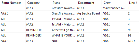

Here is my tiny SQL table, where I want ALL the rows except the Grassfire Awareness row... UNLESS, the Department is Ag Service Board OR!! or the Crew is Maintenance Graders:

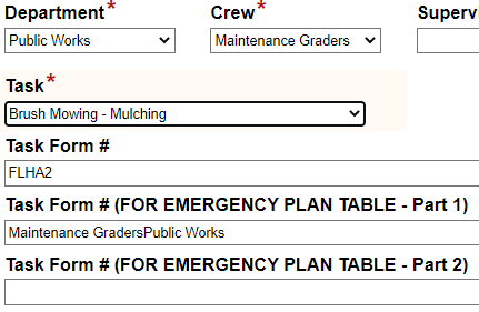

Ultimately, I need three options, but how to get them... I thought I could have hidden fields collecting the department and crew fields, then have the if statement of If (this) or (that) then _____ and there would be another column in the SQL table to match up with.  But I haven't been able to get the if statement working and haven't been able to decide on what the extra column in the SQL would be yet.  Do you think something like this would work?
I've unhidden my collector fields for now and you can see the Part 2 isn't collecting anything yet (simply because I haven't found how to say "if Part 1 contains ______ instead of equals _____ [one of the two exceptions]).

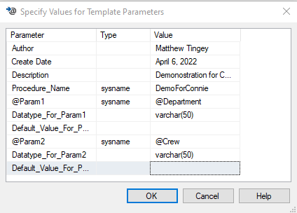

Notice that says to press Ctrl+Shift+M to populate Template Parameters.  You'll get a popup like this, which you can fill out similar to how I've done in the screenshot (obviously using your name instead of mine and a more appropriate description).
Now it should be looking something like this.

Okay, I have come up with a temporary solution that I'm excited about!
First:
  • I have the Part 1 hidden field filling whenever the Department is Ag Service Board or the Crew is Maintenance Graders
  • I have the Part 2 hidden field defaulted with just "ALL".
Then,
  • I have duplicated the Emergency Plan table and used field rules to hide/show based on what is in the Part 1 hidden field (or NOT in this field).
  • I have the lookup rules filling both tables, but one of them is told to just fill the rows where the one column says ALL.
This way,
  • If the Part 1 Hidden field is blank, the ALL table always is there, already filled with all the ALL rows.
  • If the Part 1 hidden field is NOT blank, the other table shows up which just fills with every row in the table.
This works!  This is actually the idea you got me started on, Matthew, but then I thought it was too complex.  But if I removed one of the Grassfire Awareness rows, then I was able to do it.  Yea!
