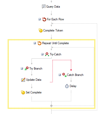

If there's no easy way to retrigger the workflow and you want the best chance of success, I usually create a boolean token like "Update Complete" set to false by default.
Then, I put the db activity inside of a repeat loop and set the token to true right after the db activity.
That way, if it completes successfully the token is updated and the loop ends, but if it triggers the try-catch and never reaches the token update, it will trigger the repeat and try again automatically (in this case I usually put at least a 1-min delay in the catch branch).
If you have the try-catch inside of the for each row on a loop, then make sure you're resetting the "complete" token to false at the beginning of the row loop so the success of the previous iteration doesn't affect the next one.
I usually do something like this, but again it really depends on the context.

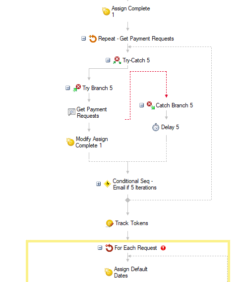

replied on April 8, 2022 • Show version history
So we started using your technique in hardening our data activities, @████████.
I just came across a scenario that surprised me but also makes sense. Looks like the Repeat activity won't allow for the For Each Row like this:
If I pull that query out of there it is happy again. I tried re-selecting it as sometimes workflow looses a connection here or there. That didn't do the trick.
I had several of these that were similar when I was implementing the try/catch method. I would have to clone all the activities down both the try and the catch branches. Thinking that may be the way to go with these. Any thoughts?
Thanks so much.
EDIT: after looking at this with a fresh set of eyes, I don't believe the activities need to be cloned. Rather they just get put in the Try branch. If there are additional data query activities, nest the repeat configuration within that Try branch. Sound about right?

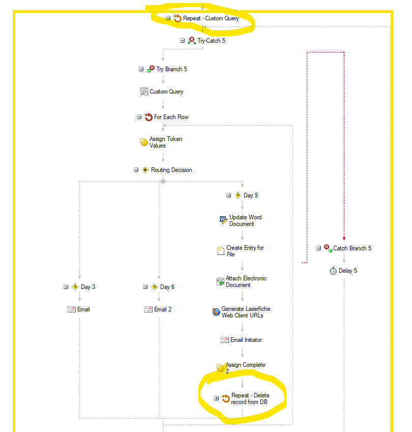

The idea that the activities could keep repeating does give me some pause and wonder if this is truly the best way. There could be some unwanted behavior if it repeats the same item multiple times. Such as (in the example above) the Update Word Doc, Create Entry or Attach Electronic Doc.
EDIT2:
I actually am NOT liking the idea of nesting the repeats. For these where a For Each Row feeds off of a query, our best idea is to keep the query in the repeat and put an invoke in with it. send the value per row through the parameters of the invoke.
replied on April 11, 2022
Yes that's right. Some tokens become unavailable to other activities when they are inside of a repeat loop because of how they are tracked.
With most you can just assign them to another token, but for things like a database lookup that return multiple rows, you need to put everything inside of the repeat so your for each row can access the data.
